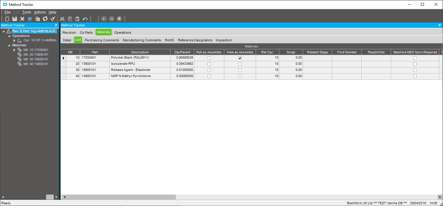

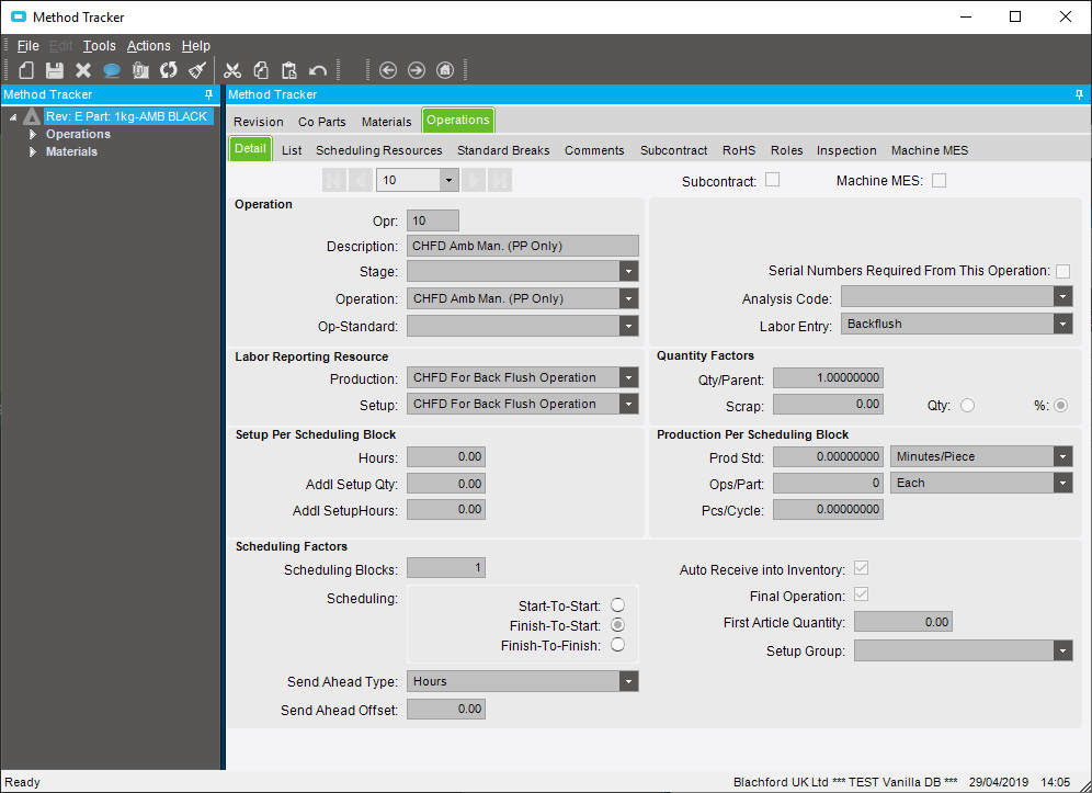

Can you show some screen shots of the MOM from the part in part maintenance you are trying to add?
Hi @jeowings. I’ve checked and I haven’t yet created any BPM’s against Quoting in our E10 Test system.
Screen shots for the method of the assembly are below (please note, these are exactly what were carried across from our V8 conversion which works fine):
We have been advised by Epicor that our system is working as expected. Would it be possible for anyone on version 10.2.300.8 or above that if they add a Phantom BOM (with appropriate approved revision) to a Quote if they have the same functionality as we are seeing? Thank you.
(RECAP: Functionality we are seeing is that when we add a part number that is a Phantom BOM to a Quote Line the system automatically breaks the part number down and instead adds all the materials within the BOM to the quote separately instead. It also adds an extra Operation to the Manufacturing Details within the Quote)
