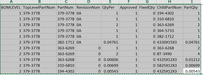

The first example below is how the data currently comes out of the report
BOMLEVEL TopLevelPartNum PartNum RevNum QtyPer Apprvd FQty ChildPartNum PartQty
1 379-3778 379-3778 0A 1 1 0 194-4302 1
1 379-3778 379-3778 0A 1 1 0 310-6810 1
1 379-3778 379-3778 0A 2 1 0 363-6269 2
1 379-3778 379-3778 0A 1 1 0 364-5733 1
1 379-3778 379-3778 0A 1 1 0 382-1712 1
2 379-3778 382-1712 0A 0.04761 1 0 4330X15X3 0.04761
2 379-3778 363-6269 0 1 1 0 363-6268 2
2 379-3778 363-6269 0 2 1 0 8T-3490 4
3 379-3778 363-6268 0 0.00606 1 0 4325X12X3 0.01212
2 379-3778 310-6810 0 0.00699 1 0 5825X12X3 0.00699
2 379-3778 194-4302 0 0.00543 1 0 4325X12X3 0.00543
