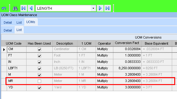

There’s a filed in the UOMConv table that indicates if the conversion has ever been used. You can show it with a personalization of the UOM Class form. In the following I un-hid the HasBeenUsed column in the UOM’s List sheet grid. I have one Length type that has never been used.
