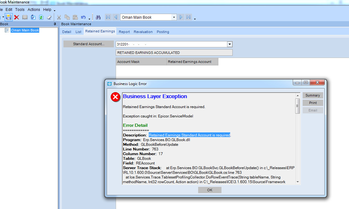

Hi Friends, I am new to Epicor. Kindly help me on the below issue.
Although the GL account in master is present, while creating Book Entry and putting account code 312201, I get an invalid code ‘note like’ error msg and while saving, i get error as per attached image .
The account number you provided is incomplete. Looks like you have 5 segments to your GL accounts. Need to assign values to the remaining segments after 312201. Example: 312201-00-00-00-00
Thank you Zack for reply,It got fixed when i created the corresponding gl account entry.
Before only account segment was there.
