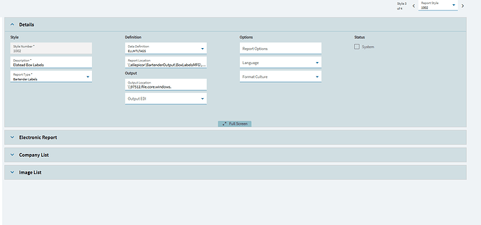

Hello we have started testing Kinetic Cloud we have been given an azure file share for dumping files how am i meant to generate a mtl tag from the box labels to remake it on bartender the top one is how it currently looks on local server
at this stage I am just trying to get the MTLtag.txt file to come out of epicor into the file share :slight_smile:

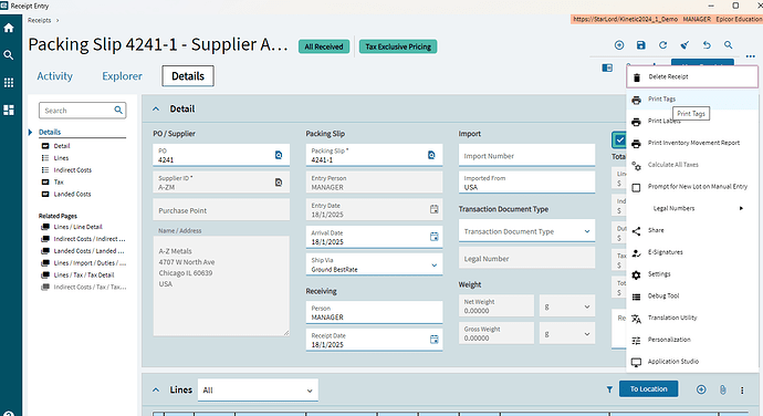

So you need to trigger the label print which if I recall you can do in Receipt Entry

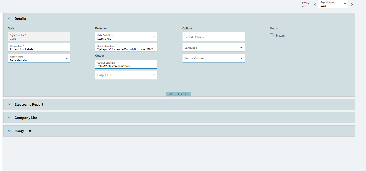

Thank you I have managed to get all the way through when replicating similar to our on prem setup the only issue I have now is on integration builder it errors when trying to scan the kinetic azure file share as it does not have correct permissions…
