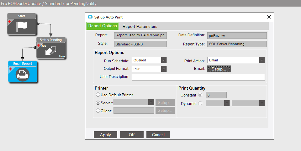

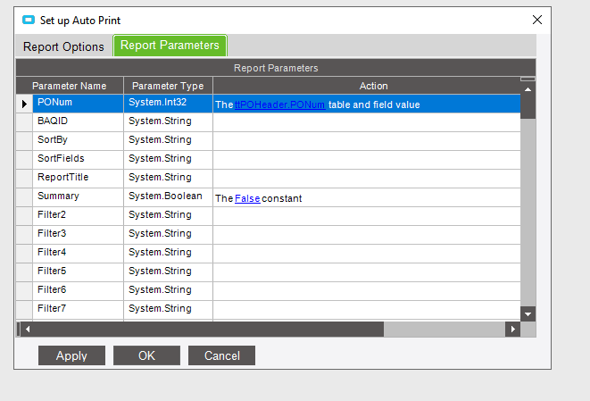

I have a report that gets emailed when Purchase Orders are pending. Using a BPM with the auto print object (though setup to email). I use a standard data-directive on the POHeader.
The PO is passed as a report parameter
It looks like you can specify “QuotForm” with auto print and pass the report the “QuoteNum”

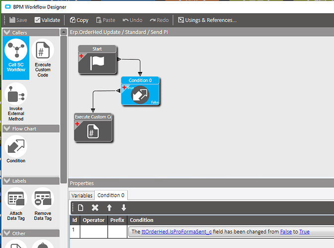

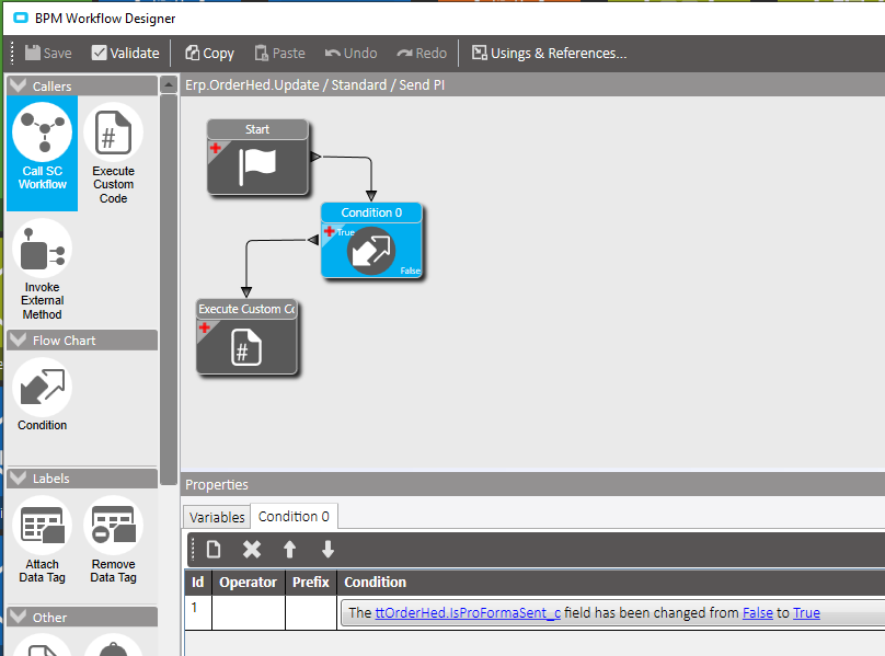

This is the BPM
and the custom code

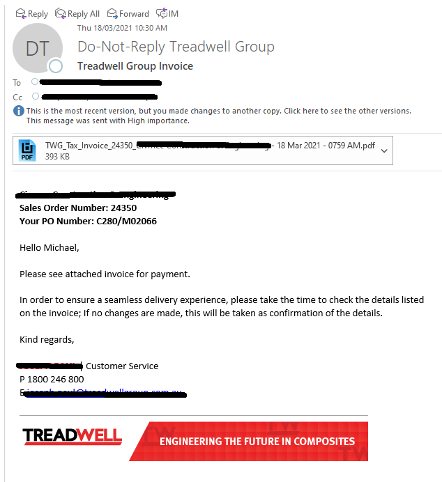

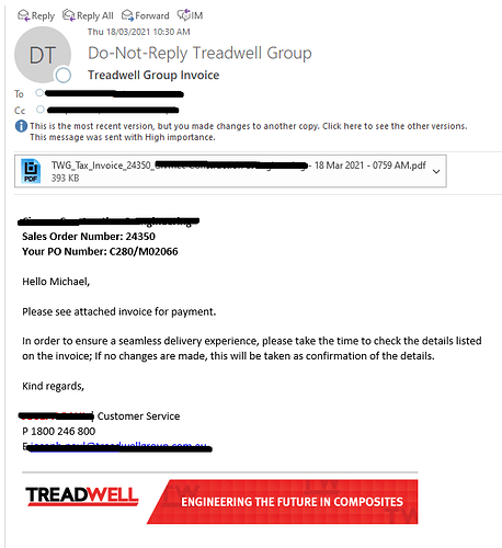

And what it looks like
