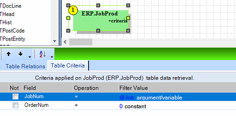

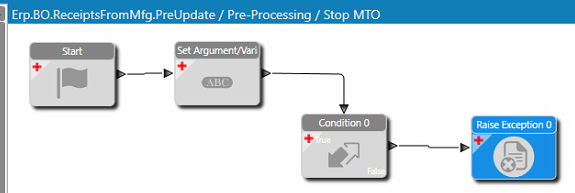

BPM - BO.ReceiptsFromMfg Condition table to JobProd
I’m trying to put in a condition where if a job is MTO, do a stop warning so the users cannot do a job receipt to inventory. The JobProd table does not exist in the BO.ReceiptsFromMfg so how would this best be accomplished using which widgets in the Method Directive where JobProd.OrderNum has an existing value as a condition?
I put PartTran.JobNum into a variable and used that to check for a make to stock demand link and throw an exception if none are found.
