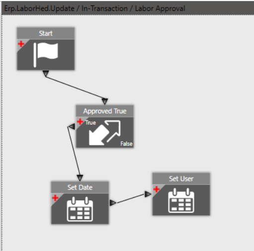

We have a BPM that will stamp a custom UD field for user tracking on the LaborHed record. It is a simple data directive that looks like the following:
This works fine for all necessary users but 5. After some troubleshooting I found that it fails on the callContextClient.CurrentUserId variable. If I override this to use “any text” it will write to the record but will not user the CurrentUserID variable for the 5 users. If I recreate the user with a different username it will work.

Interesting. Sounds like for some reason the BPM isn’t capturing a userid for those folks… are they following the EXACT same procedure for entering labor as everyone else is? What is the actual “approved true” condition logic?

Same exact process. I have done it to verify and troubleshoot. The approved logic is “field: Approved_C has changed from any to TRUE”
