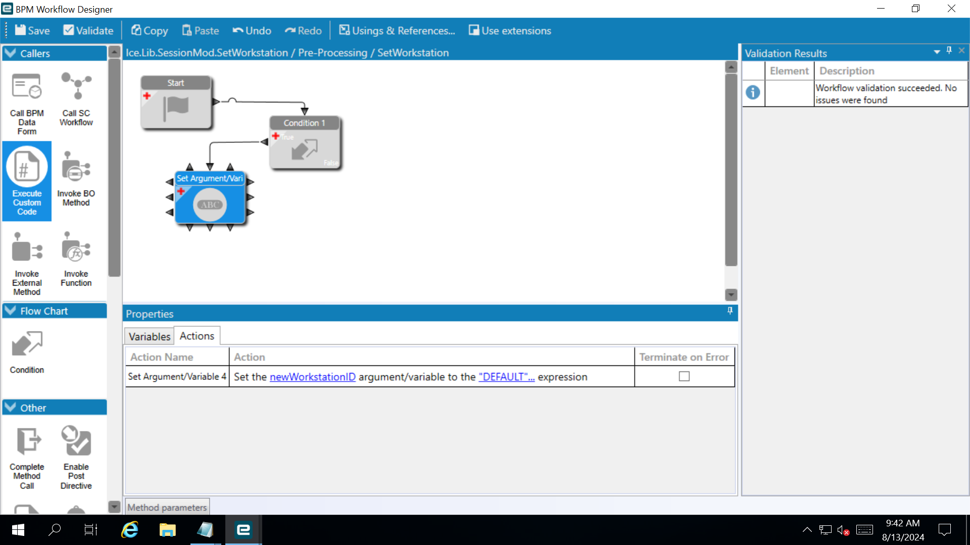

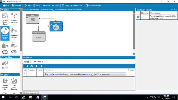

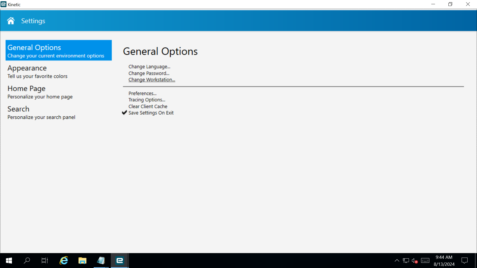

I have written a BPM when the end-user has selected the “None” workstation using Change Workstation option we need to set as “DEFAULT” workstation. But this BPM is not working.
Anyone can suggest how to resolve this issue?

Pre:
if(String.IsNullOrEmpty(newWorkstationID))
  newWorkstationID = "A0048";
  InfoMessage.Publish($"Setting workstation to... {newWorkstationID}.");
Post:
InfoMessage.Publish($"Workstation is.... {newWorkstationID} and description is .. {workstationDescription}.");

Client still showed the old workstation.
Messages came back correct.
Logged out and back in and client showed correct.
