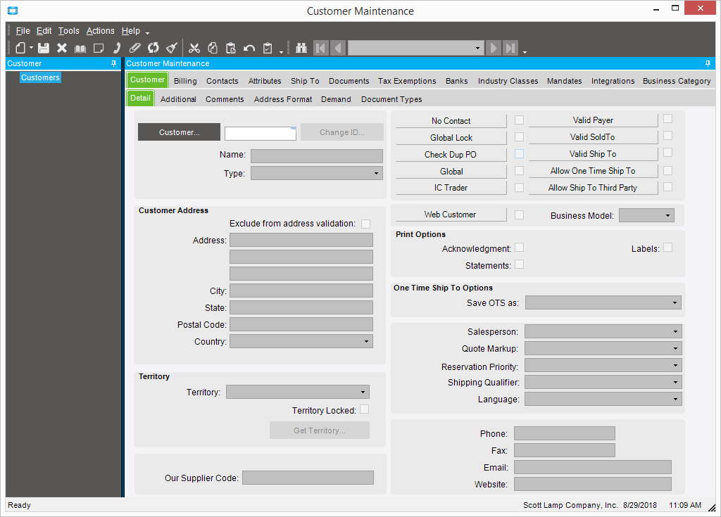

Under Customer form, there is an option to verify duplicates already…
Pierre

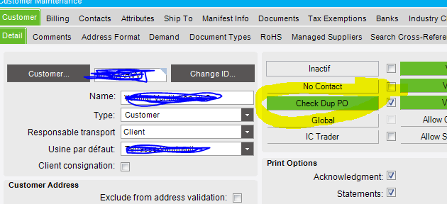

Do it in customer maintenance.
Check the Check Dup PO box and the system will do it for you.
Thank you. That’s much easier than I was trying to make it.
That is a hard stop. If you want just a warning, it would need to be a BPM or screen customization.
