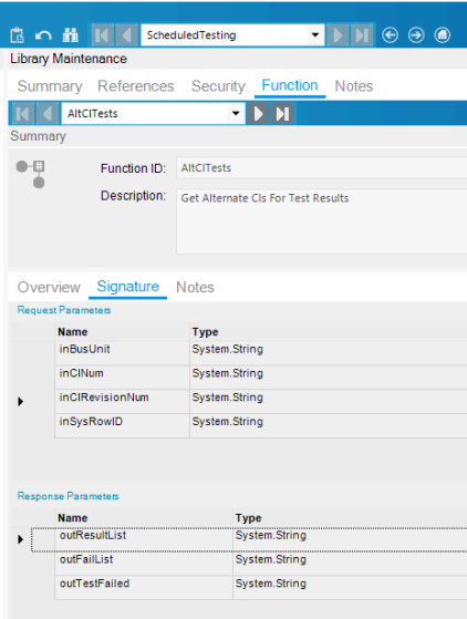

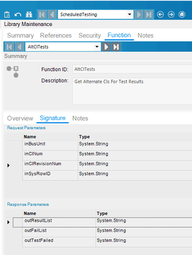

Here’s the function signature:

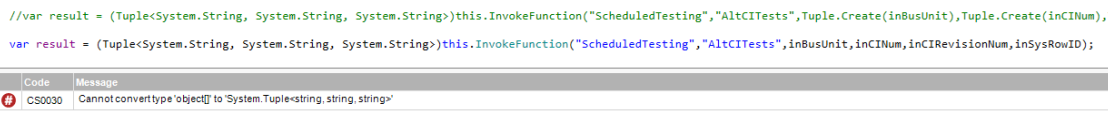

And the code trying to access it:
var result = (Tuple<System.String, System.String, System.String>)this.InvokeFunction("ScheduledTesting","AltCITests",inBusUnit,inCINum,inCIRevisionNum,inSysRowID);
I’m getting the error “Cannot convert type ‘object[]’ to ‘System.Tuple<string, string, string>’”
