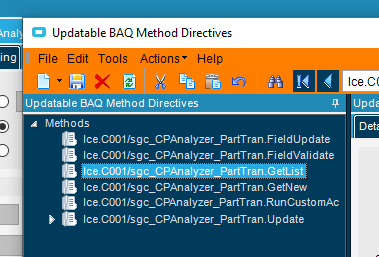

This seems like an odd way to trigger this. I think that this might be better to put the code into Ubaq and then schedule the BAQ to run using the BAQ Export process. Data directives can be problematic when running code in them. Plus it will be easier to test in the BAQ, AND, you can return all of your data needed to find the lines to close in the BAQ then run the code after so you donât have to do the lookup in the code. (both ways work though)
Make the BAQ an updateable BAQ, then on the update tab, change this to Advanced BPM Update Only. Then click on the BPM Directives Configuration, and youâre into BPM land again. This only applies to this BAQ so itâs nice and contained. If you want it to run anything you run the BAQ (like when you do an export) put the code on getList Post Processing. But you have lots of options to put in BPM style code.

WHAT I ENDED UP DOING:UBAQ WITH CUSTOM BPM CODE ON GETLIST METHOD
This is the only thing I tried that worked with losing the expired quotes one by one looping through the results of my UBAQ ttResults table. Instead of querying the Quote and Task data from QuoteHed within the C# I just used the results from the BAQ I designed to return the right rows I wanted.
I basically use a foreach to scan each results row and lose the quote task one by one. Works like a charm. BPM Code below⌠(sorry for bad formatting in post, trying to figure out how to properly format C# blocks here, forgive me):
