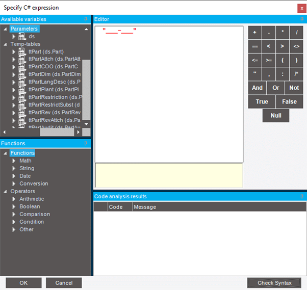

My problem is how to fullfil step 1. I have tried both of the following C# expresions with no success:
-” (three underscores a dash and three underscores)
“^\d{3}-\d{3}$”

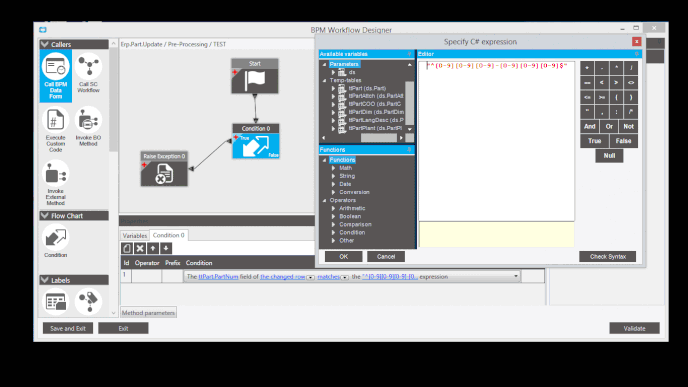

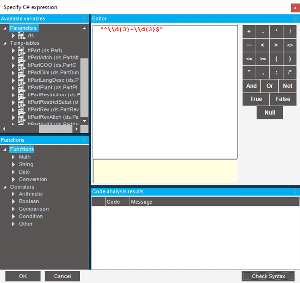

Sorry all, the exact contents of the strings I tried appears to have been displayed incorrectly (my bad).
So, a couple of screenshots to supply the correct info:

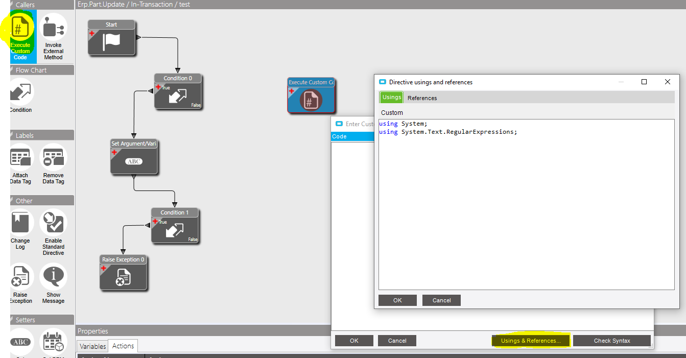

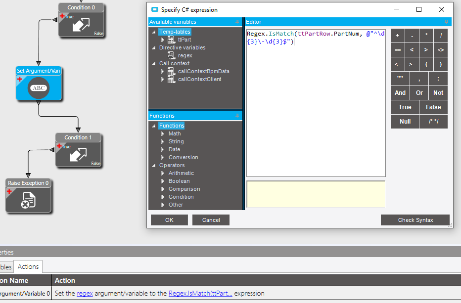

Here’s how I was able to get it to work:

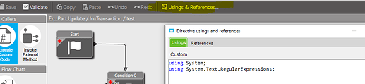

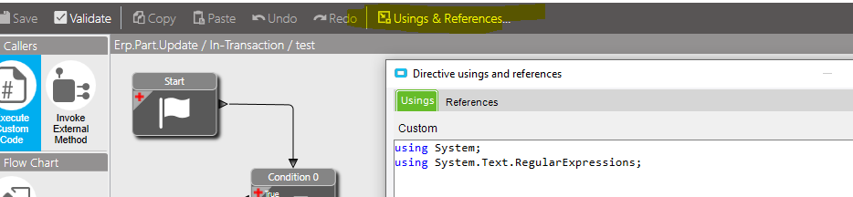

Add Usings/Refs

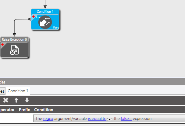

Create bool variable, set to regex.match expression
Then you can use that variable in a condition to raise the exception
(true = match , flase = no match)

Added a few screenshots to my previous post :+1:

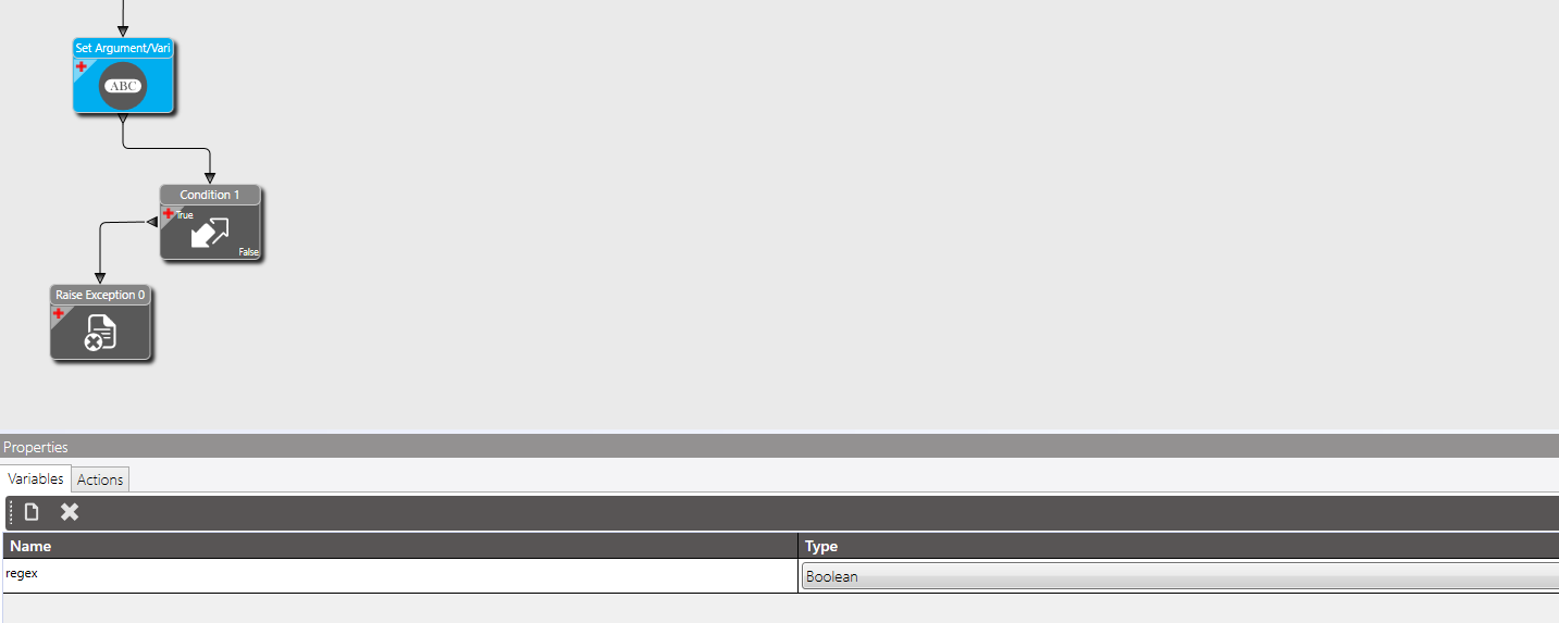

I have created the set Argument/variable Task, created the variable “Regex” but when I try to add the C# expression it thows an error:
The error mentions a using directive which I can see in your screenshots bit do not know where it is in my Epicor version
Gotcha. In-Trans v Pre-processing shouldn’t matter in this case. I was just testing mine in a data directive (rather than method).
First, change your variable name from “Regex” to “regex” or “regexTest”. Regex with a capital R is the class you’ll use that has that isMatch method, and you will confuse things naming the variable the same thing (sorry for the confusion).
I’m not familiar with your version (your profile says 10.2.300 btw), but you should be able to add the "using"s via a custom code block. You may need to connect the empty code block you add these usings to (and put in the beginning after the start widget), but I’m not sure.
If you don’t have access to the custom code widget, you’ll need the “BPM Advanced User” checkbox checked in the user account security maintenance module to get it.

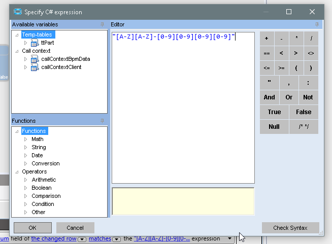

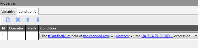

Here it is in a working DD
For my test, it was looking for cc-nnnn where c is a Char A-Z, and n is a number from 0-9

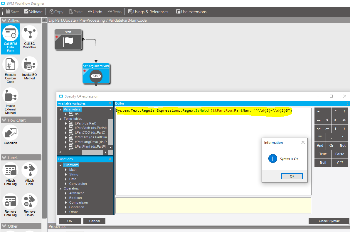

Try this, add this formula to your variable widget

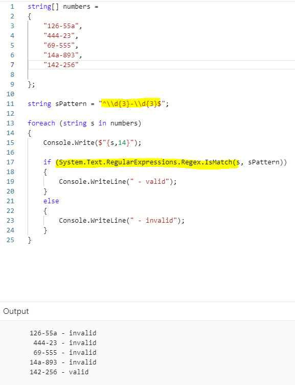

yes of course my variable is defined as boolean because the output from this function is boolean i.e. true or false, and this apply to @Asz0ka solution as well, i just confirmed that this function/method will do the job, i have tested it within Epicor and outside C#/.NET running app, the only different is the backslash position and number. image
also the function does not required to add any using to the class it is already defined within the std class called subroutine (code library), at least in my version.

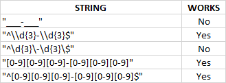

Thanks all for the contrributions, I now has enough information to resolve the issue:
The following grid shows which of the strings work

So in summary a screenshot to show all relevant info:
