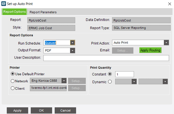

I have a Data Directive BPM that is setup to autoprint a Job Summary BAQ Report.
When i select the “Client” printer option in the Autoprint setup - it works fine. However, i would like to defploy this to all our MES stations and i would prefer to use the “Network” printer or “Default” printer.
However, both the Network printer and the Default printer fail in the system agent with "Unable to open printer. Error 1801: The Printer name is invalid.

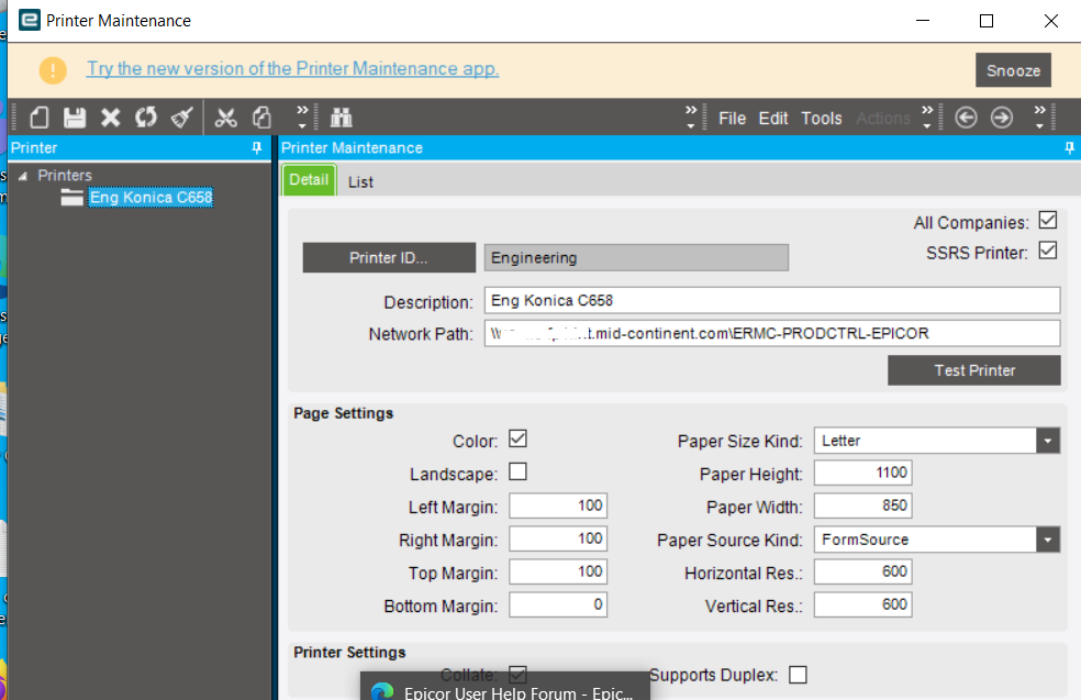

I have double checked the UNC many times and it seems to be OK. The Printer is shared on the network.
