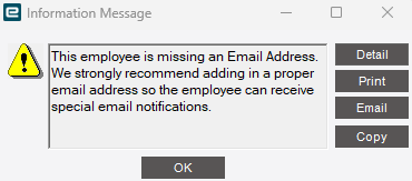

I created a BPM which check field if that field is not filled than show error message, which is working, I was able to X out of it and it still saved without fill that field, I really don’t want it to save without entered in the field. how to do that ?

Switch from an InfoMessage to an Business Logic Exception.
throw new BLException("The naughty monkey was here.");
do you mean use Raise Exception instead of show message ?
Yes he does. (He gave you the programmer’s answer.)
working thanks
