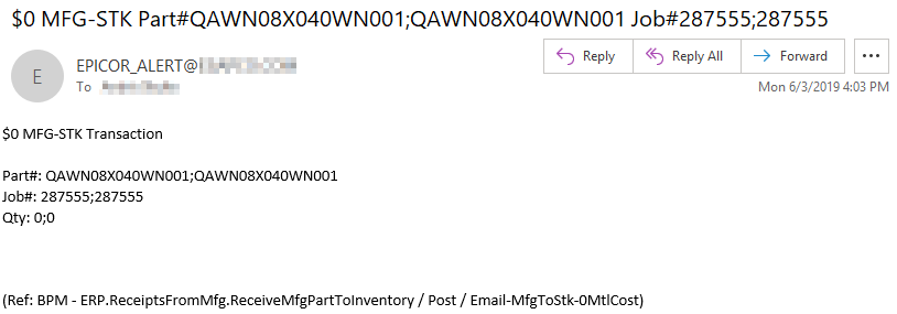

I created an POST BPM for an email alert to notify our cost accountant when a mfg-stk transaction has $0 material cost (so she can chase down the outlaws!). :slight_smile:
The BPM seems to fire properly, but the added fields in the email template either get repeated, or don’t show at all.
If I chose “Added Records” and “Updated Records” (like we have on all our other BPM Email Alerts), then I don’t get anything at all. If I have “Unchanged Records” only, then it shows the field twice.

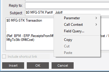

Use a Field Query instead of a Table Query
It was a field query - When I click on the Subject line in the Design Email Template, then click the Insert button, table query doesn’t appear as an option. We’re on 10.2.300.12, if that changes anything.

If I don’t have “Unchanged” checked, then the data fields don’t show up in the email at all.
Darren, it acts the same as the email. If Added and Updated is checked, then nothing. If Unchanged is checked, then double.

I did some testing on the same BO and method and found that I get the same thing as you.
If I change it to a Pre-Proc, and only have the “Updated records” box checked on the table query, I get a single value.
How the added vs unchanged is handled is per BO and a lot of time per call. Some calls esp in the Job area take two records a changed and unchanged record. Other time that is not the case and you just have the changed. It’s seemingly random and likely due to two different camps in Epicor development at different points of time in how dirty rows should be handled. Ever try to use a data directive with “where field changed” and it doesn’t work? That’s one of those cases it needs the old and dirty record and both were not supplied. That can happen with custom code and sometimes even Epicor native doesn’t pass the clean and dirty.
