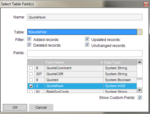

Second Question - What does the filter do in “Select Table Fields”? I couldn’t find anything in the help or BPM Epicor Education documents.

The filter narrows down the records sent in the email those that have been (Added, Updated,Deleted, or Unchanged) Selecting all filters none

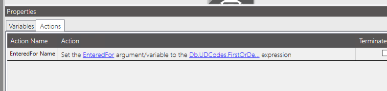

If it’s a few fields, you can use the Set Argument/Variable to assign a BPM Variable to a data field with a single line of code. Then call the variable in the email “node” template.
Db.TableName.FirstOrDefault(uf => uf.RelationField1 == RelationField1… ).Field-you-want-to-display ?? “”
Example code: Db.UDCodes.FirstOrDefault(p => p.Company == callContextClient.CurrentCompany && p.CodeTypeID == "CSR" && p.CodeID == ttOrderHedRow.udEnteredFor_c).CodeDesc ?? ""

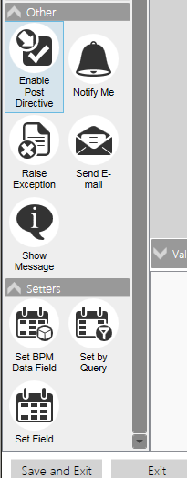

Thanks for the idea. I don’t have the Set Argument/Variable in my BPM Workflow Designer (in Pre, and also checked Post). Maybe it was added after 10.0?
Would I be able to do something similar using the Execute Custom Code widget?
Thanks again.
There was a lot of stuff added between 10.0 and 10.1.
