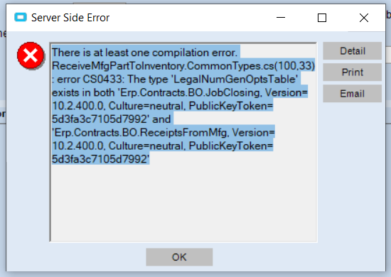

BPM Error Message
Guy’s i am working on a BPM to close jobs on the job receipt to inventory.
The BPM runs on the Erp.ReceiptsFromMfg.ReceiveMfgPartToInventory Pre and Post Method.
The Pre Method checks if all the ops are complete. Then go onto the Post Method.
The Post Method simply runs the code below.
The messages are just for debugging.
The first step is to get the QtyCompleted from the job.
The 2nd step is to check the PartTran Table for the QtyBooked to Stock.
The 3rd step is to check if the QtyBooked to Stock is equal to the QtyCompleted. If So then close the job.bpm error

Oof, that’s the notorious “type exists in both” bug… you can search this site for many examples.
Sometimes you can find clever ways around it, sometimes you are sh** out of luck.
I think @hkeric.wci is the expert on this, maybe you can pique his interest.
You do not need code to auto close jobs. Have you tried Auto Complete and Auto Close Jobs under Job Management.
There is no easy fix for that one. The only options that have worked for @josecgomez myself and others are:
  1. You need an External BPM to do that logic
  2. You need an Updatable BAQ which uses Advanced BPM to do that logic. Then your original BPM Calls the UBAQ. (Usually Pre EFX this is the way we have done it)
  3. You need an Epicor Function to do that logic
  4. You need to move the logic to another BPM that doesnt conflict with the same Table
  5. You need to move logic to the UI and simply do it on the front-end.
  6. Maybe you can Invoke UpdateExt pass through the dataset and maybe in the UpdateExt you can do that logic.
  7. Some people Use UD05.GetByID or GetList and hijack that BPM of a Table they dont use and invoke it.

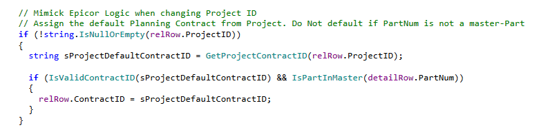

Sometimes when I am just moving my own fields MyField_c and I also would like to Default in an Epicor Field. I do the same, especially if its a harmless field but I always make sure to Reflect on Epicor’s code to understand what else I should be updating.

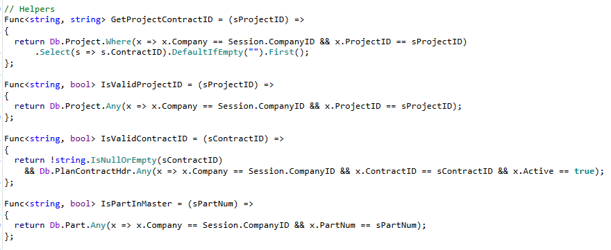

For example:
Take Project ID from POSugg and Default it into the PO.
Once I reflect on Epicors code They do a few checks and also bring in the ContractID, so it’s not always just as easy as Project ID :slight_smile:
I guess you have to make best judgement. Also after some major upgrades, sometimes review if Epicor added more checks/balances/defaults :slight_smile:
When it comes to something more complex like Closing a Job or Engineering a Job, or a Key Field (CustID, ShipTo, Etc…)… I try to stick to BO’s. Way too much logic to replicate.
It is mostly impossible. In general, assembly aliases were designed to solve conflicts with 3rd party libraries that cannot be changed in the scope of a consuming project.
I don’t plan to add such a thing to BPM. It is an overcomplicated and fragile approach.
Probably, aliases will be added to the EFx but it is not a short- or even midterm task.
So, AFAIU, moving part of logic to a function is the only solution available for now.
