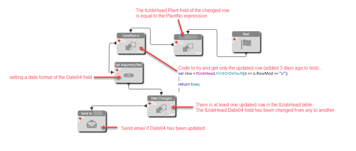

here is the Data Directive BPM info

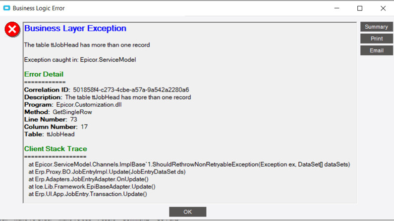

The error

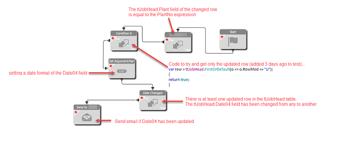

The operation
Send an email if the Date04 field is updated.
If i turn this BPM off, any other changes to the Job Entry are succesful. If i turn this BPM on, i get the error
