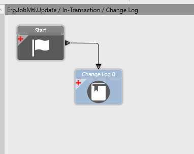

@richgibbons - Sounds like you want to add a ChangeLog to the JobMtl table.
Make a DD of table JobMtl, of type In-Tran.
Add the ChangeLog Widget
Select the fields to log when changed.
Now anytime that filed gets changed, it will be recorded.
