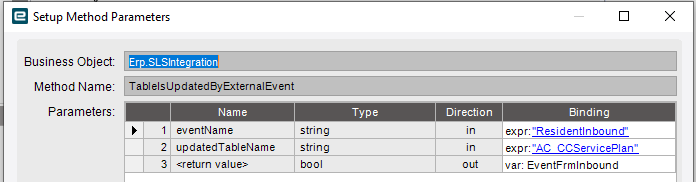

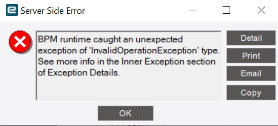

I am inside the Update method directive for a Service Plan form. An external process is sending an object with the above data into Epicor. My current BPM starts if a row has been updated on the Service Plan table. I then invoke BO method (TablesUpdatedByExternalEvent). If the external event argument is false I then set “callContextBpmData.CharacterXX” field to the data field expressions. When I put an exception message at the end of my BPM to display the bpmData characters, I instead get this generic invalid operation error:

Well first things first, click Detail, and lets see the full stack.
That would help!

If the 1st condition - “There is atleast one updated row in the ds.AC_CCServicePlan table” is true we invoke the below method as the data was pulled in through an external API.

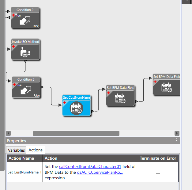

Next if the EventFrmInbounc variable is = true, it will set “callContextBpmDataCharacter01 - 04” fields with the 4 data fields (CustID, AreaID, CustName and Package) respectively.

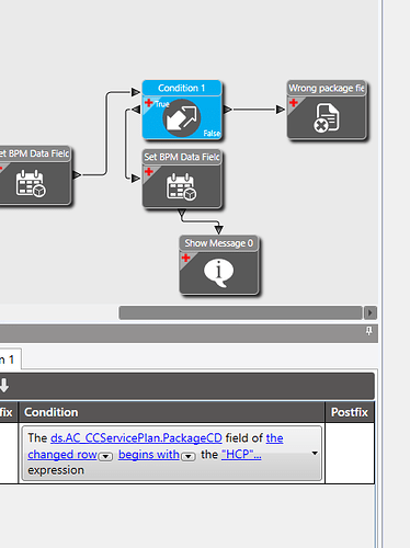

We then arrive at a filter, if the Package.CD begins with “HCP” set the data field, if it doesn’t throw an exception.
From here I wanted the message to display below:

Remove that link between Invoke BO Method and Condition 3 so the rest are orphaned.
See if the error still occurs.
If it does, you have a problem there.
Can’t answer that one, I don’t have that integration module, and still trying to wrap my head
around what you’re doing :slight_smile:
The link has been removed between condition 3 and Invoke BO Method and I am still getting the same error as above.

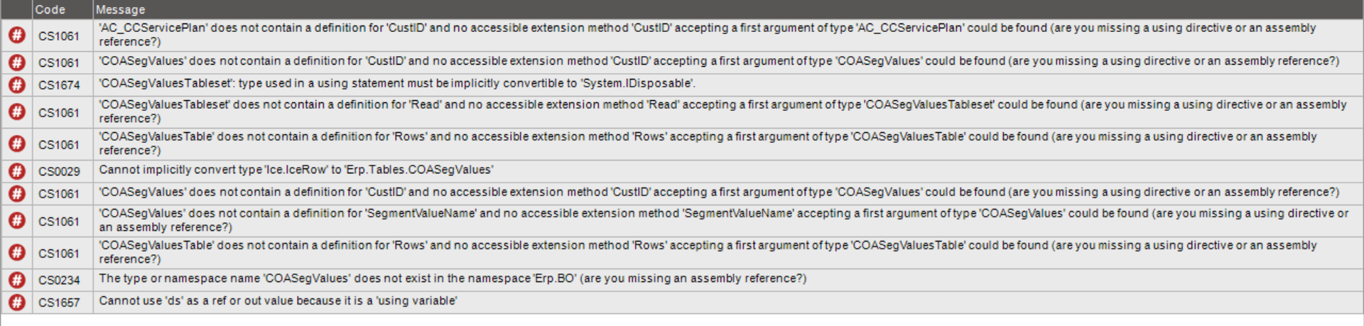

What are your errors?
I am familiar with C# referencing somewhat and I’m unsure what to change for example the custID not being an accessible extension method, I am trying to access a field called custID (or custNum) inside the COASegValues table so I don’t know why that error is occurring.
I don’t know how to proceed with any of these errors and need some guidance. The referencing of methods, classes libraries for example I am familiar with however I am new to epicor so still trying to wrap my head around how it uses the ICE Library and method directives etc…
