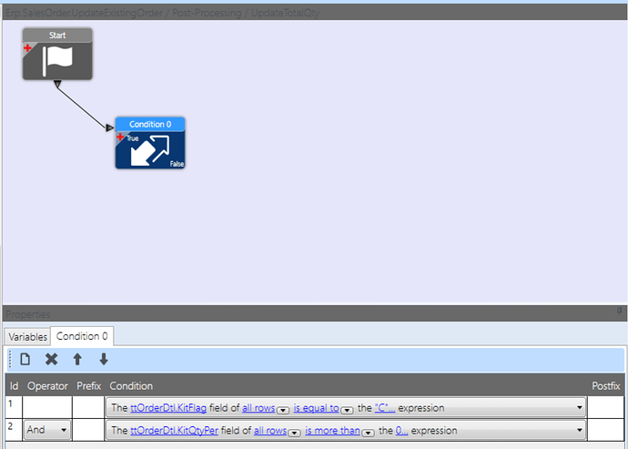

Here is what I’ve done so far. It’s the next step that has me worried. Everyone I have talked to tells me I’m going to have to write code… C# and I do not mix.
The problem I am having is that I cannot see where I can take each component qty and sum them into the UD Field I created. I created a condition which I know is the start, but what do I put next? Another condition, or do I put a caller (Execute Custom code) and take a crack at writing the code?

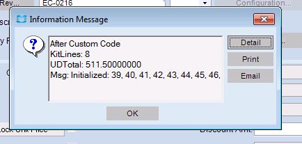

Here’s what I get after changing the QtyPer of Kit component Line 37 from 0 to 1:
The UDTotal is the sum of the KitQtyPer, for records that have the same KitParentLine

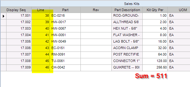

Here’s the Lines \Kits Detail \ List tab
The sum of the Qty Per column = the UDTotal field I shows in the Message above. The KitLines will be one less than the number because it only counts the other lines for OrderDtl (it excludes the line being changed), The Msg: … Field shows the lines used from OrderDtl. Note that the line that was changed (#37) is excluded.
