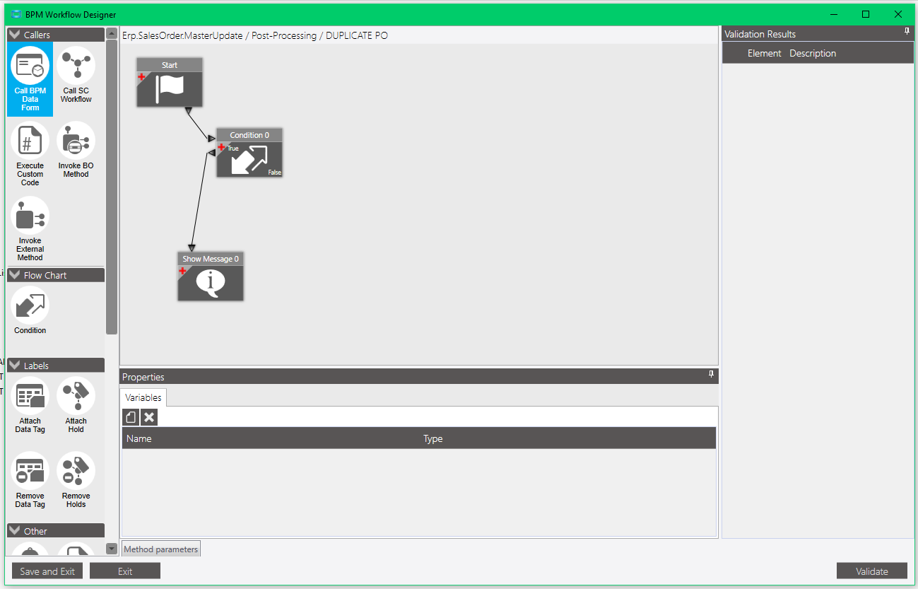

I am currently trying to create a BPM that will pop up a warning message when a duplicate PO is used on a Sales Order, but will not stop the user from entering the PO number as we have customers that will re-order products using the same PO. We are using Epicor 10.1.400.0 currently and I’ve tried to write the BPM on the SalesOrder.MasterUpdate method directive. I can get it to where the message will pop up but it will show on everything that is put in the PO box instead of just on duplication. I’ve tried using the “Number of rows in the query” condition and have added:
CustNum=OrderHed.CustNum field
and PONum=OrderHed.PONum field
I’ve seen other users say to add
OrderNum <>OrderHed.OrderNum field
I’ve tried that and the message will no longer show.
Any suggestions on how I can do this differently? I’m still fairly new to BPMs so any advice is much appreciated!
I know that we can check the box on the Customer Setup but that is a hard stop on a duplicate PO. We’re just looking for a warning. Thank you for any help!
I am trying to put a date range on this BPM so that it will only fire if the PO number has been used in the last 90 days. So if the PO was used beyond the 90 days we won’t get that warning message. I’ve been playing around with the BPM and just cannot get it to do what I’m trying to do. Would you have any tips? I’ve tried adding a second line on the condition with an “OrderDate=ttOrderHed” and played around with the less than, not less than, etc wording. I’ve also tried the specified time frame option but I wasn’t doing something right there and it wouldn’t work either. Thank you for any tips you might have!

Hi @SueLowden I’ve tried using the “Execute Custom Code” option and copy and pasting this into that. I configured it to use the code synchronously and it gives me this error: Error CS0103: The name ‘Compatibility’ does not exist in the current context [InTran.DUPLICATE_PO_CHE.cs(78,96)]
Am I adding this in the correct place? Should I change it to asynchronously?

Remove the Compatibility bit from the script and give that a go - however if you are on a newish version of E10 you may find an option on the Customer record without having tocode
I’m still struggling to add a date range on this BPM, does anyone have any ideas on how to have the BPM only fire if the PO has been used in the last 90 days?
You should be able to add a condition. “the number of rows in the defined query is equal to 0” or whatever it’s called. You can design your query to join the PO number from the TT table to the sales order, and limit the sales order to a date range > today - 90 days.
