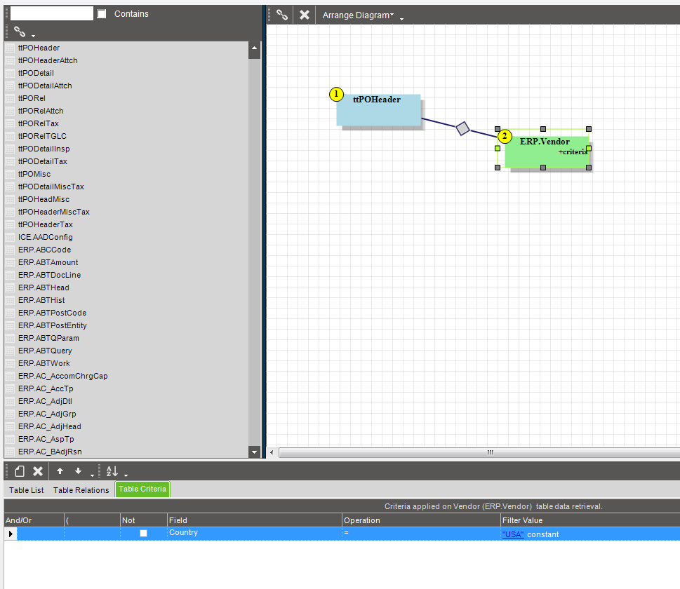

So here is my workflow:
This is my conditional query and criteria:
My message pops up for any Supplier I choose:
What could I be doing wrong? I figure its the query, but I cannot preview the query to see what exactly its showing.
Are you multi-company?
Yes.
ok what does your relationship between Vendor and ttPO look like? Click on the Line
What method is this running on?
Have you put the results for the TT table into your message box? I’d be curious to see what lines are being returned.
Erp.PO.Update
Pre-Processing
You want that message to pop up everytime record is saved? If not, your going to need criteria for added rows.
