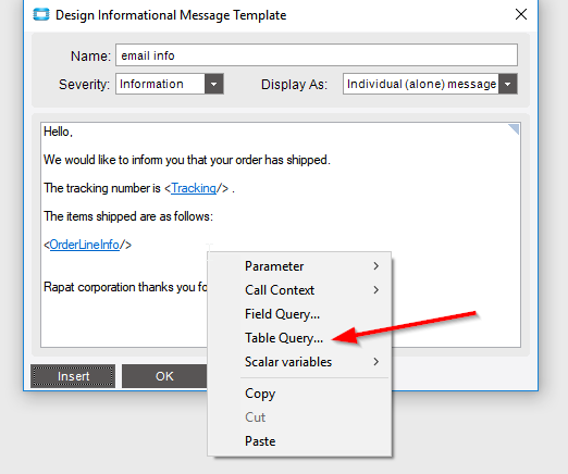

In your message box, right click and look for the table query. You can select some fields from the TT table and they will show up in your message. An invaluable debugging tool.

That doesn’t allow me to add the results of the query only the actual PO record
correct. But it at least helps to know one side of the equation. Knowing that would have helped you figure out that you needed to filter out by the rowmod like @josecgomez suggested.
