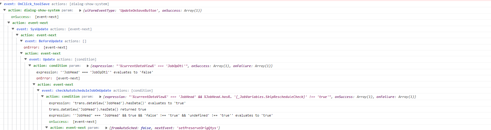

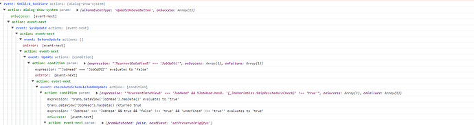

I went into debugging on the web. What am i looking for to tell me what function to use in the BPM?
