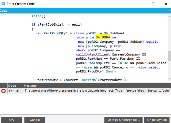

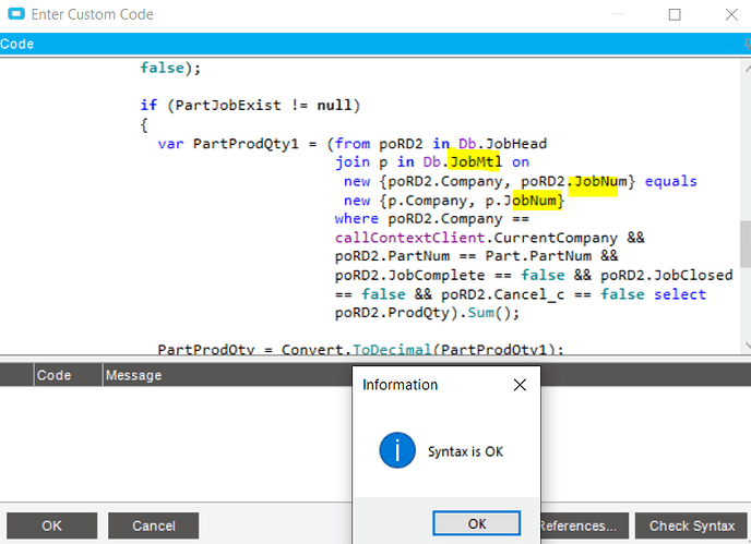

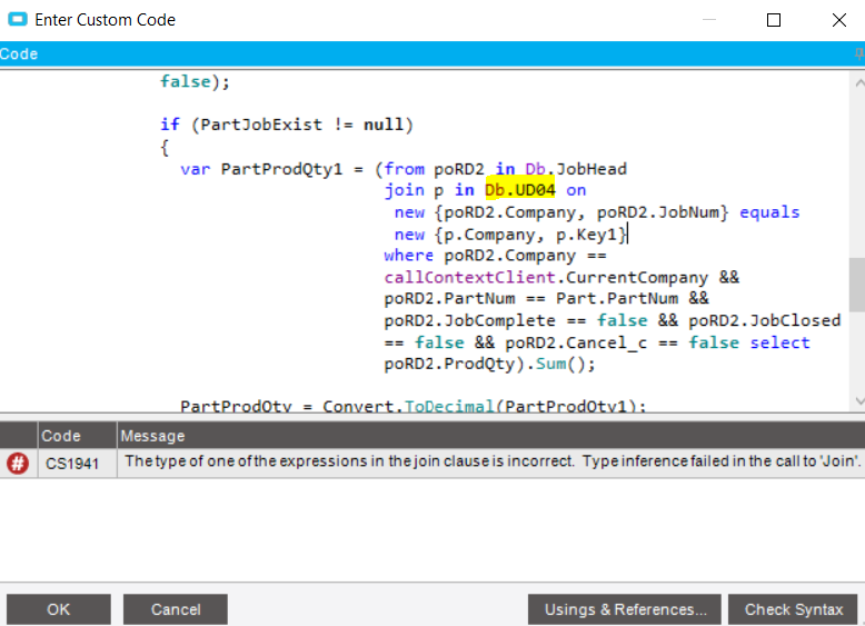

Hi,
I would like to ask how to join UD table to get the data?
Try join normal table is working:
UD table got issue:
Ice.UD04 table is used to link between Job Order and Sales Order, where Key1 is linked to JobHead.JobNum and Number01 is linked to OrderHed.OrderNum.
This BPM is used to calculate total ProdQty that had linked with Orders. If not exist in UD04 table, means the job order is not linked with Orders.
Regards,
CK Ong

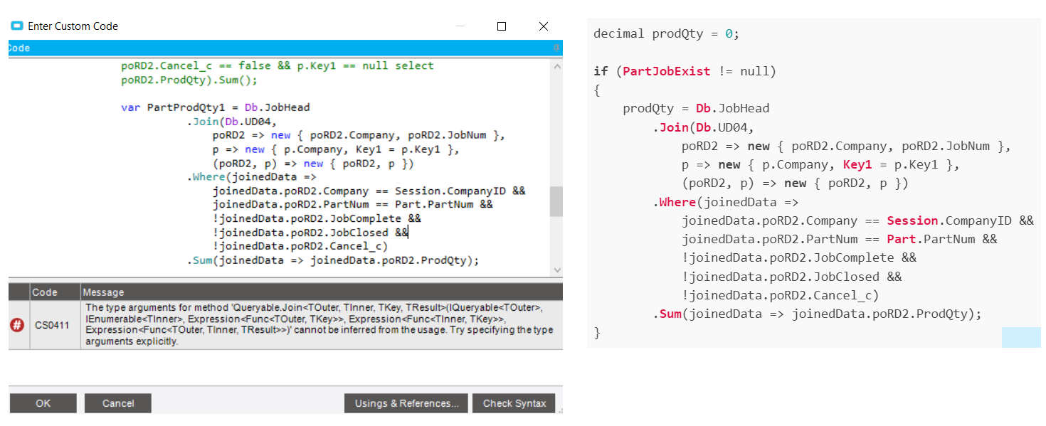

Try
decimal prodQty = 0;
if (PartJobExist != null)
    prodQty = Db.JobHead
        .Join(Db.UD04,
            poRD2 => new { poRD2.Company, poRD2.JobNum },
            p => new { p.Company, Key1 = p.Key1.Trim() },
            (poRD2, p) => new { poRD2, p })
        .Where(joinedData =>
            joinedData.poRD2.Company == Session.CompanyID &&
            joinedData.poRD2.PartNum == Part.PartNum &&
            !joinedData.poRD2.JobComplete &&
            !joinedData.poRD2.JobClosed &&
            !joinedData.poRD2.Cancel_c)
        .Sum(joinedData => joinedData.poRD2.ProdQty);
The erp.JobProd table already contains the links between jobs and sales orders, why do you need a UD table for that?

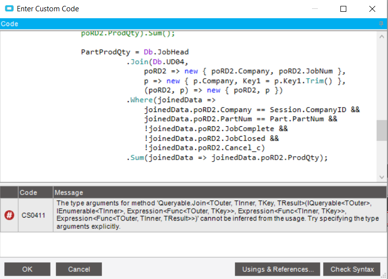

Hi Aaron,

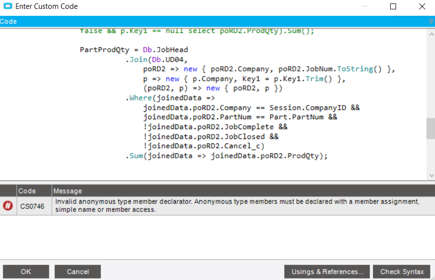

Thanks for your solution. However, i try to paste the code but encounter another error:
Regards,
CK Ong

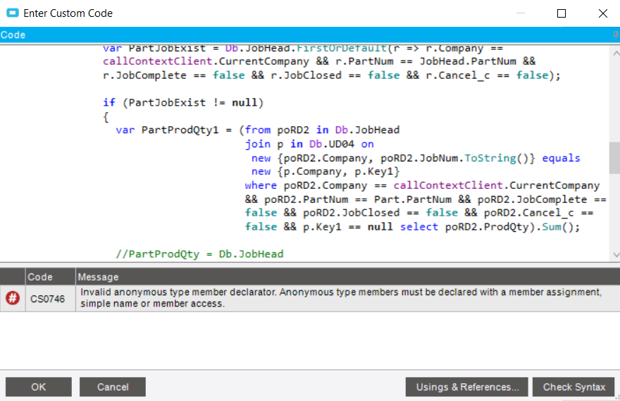

UD04.Key1 is a string, JobNum is an int.
It’s why you are getting the error.
poRD2.JobNum.ToString() in the top code should work
Hi Kevin,
I had another error prompt.
Regards,
CK Ong
I meant in your original code. Didn’t look at that code, and I gotta run :sob:
I’ll hit you back later if still needed.
Hi Kevin,
Its the same error i get after applied the “ToString” in the original code.
No problem, take your time.
Regards,
CK Ong

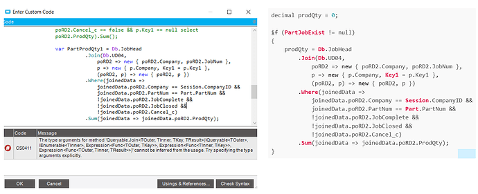

Try
        .Join(Db.UD04,
            p => new { p.Company, Key1 = p.Key1 },
Hi Aaron,
The error is same appeared as the previously posted:
Regards,
CK Ong
