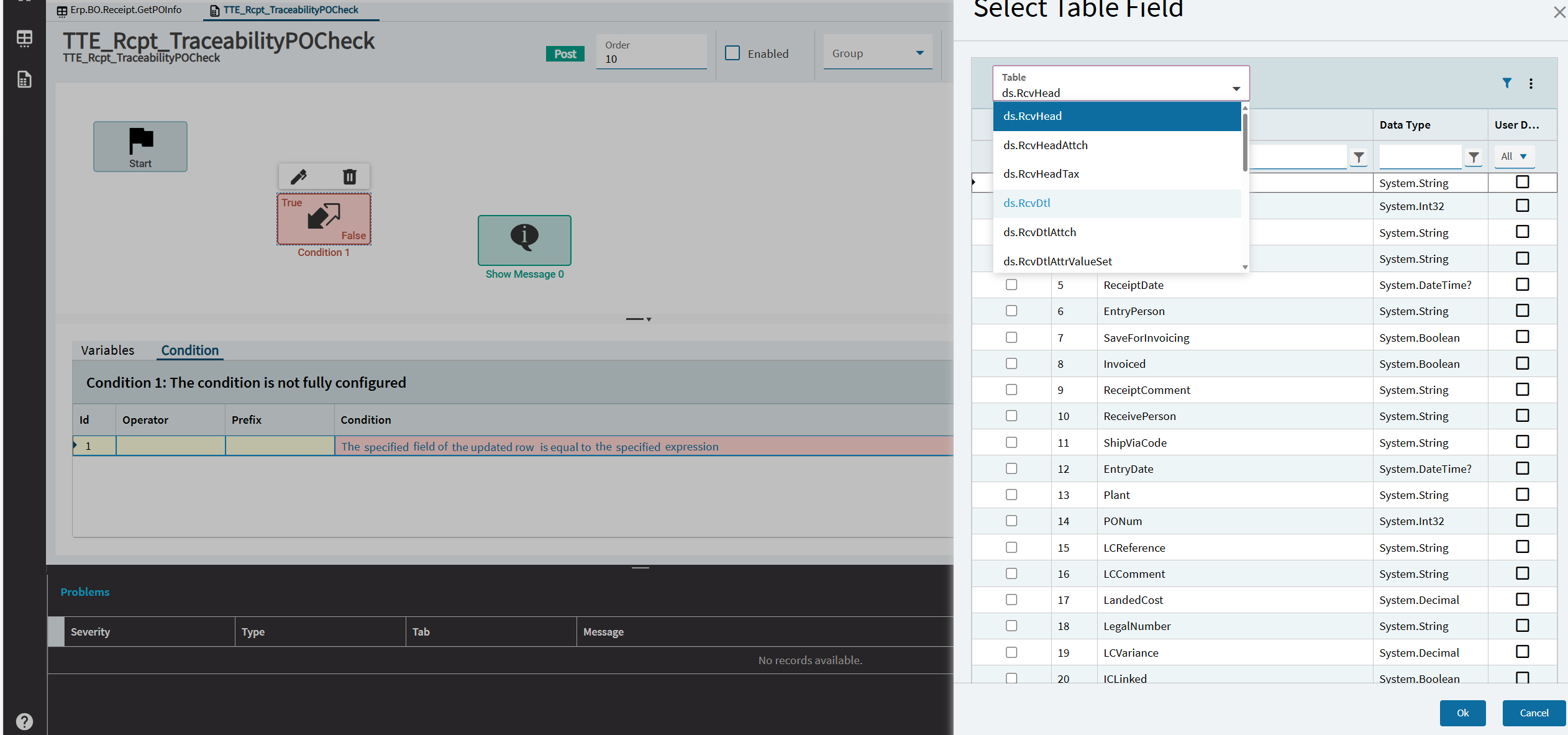

I’ve just tried to pull up the condition but the POType_c field exists in POHeader, and only the Receipt tables are available.
I’m looking to the create the condition on the Receipt.GetPOInfo method so it’s possibly why I’m not seeing the PO tables?

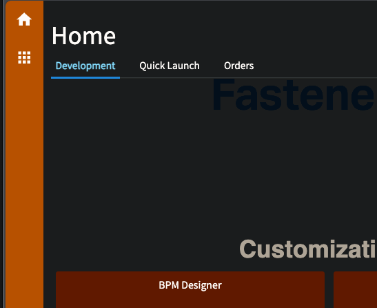

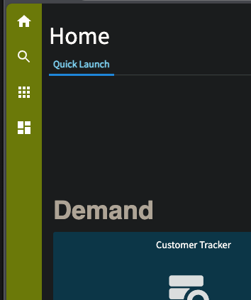

Some cool Chrome/Edge add ins!
https://darkreader.org - For the “dark mode”
Another good one is https://stylebot.dev
Style bot allows you to change certain items in the css per website.
Best example I have its the side bar colors
  • For our dev environment its Orange
  • For Production its Green
