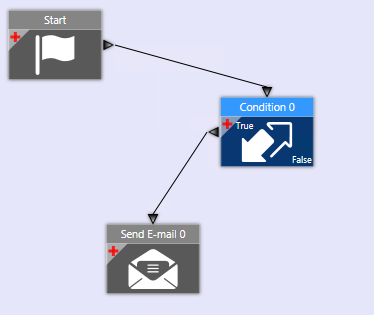

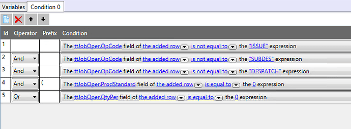

BPM on JobOper
Hi everyone, I am trying to write a simple standard data directive on the JobOper table. I want to be able to trap jobs that are created with either a zero qtyPer or a zero prodStd. The exceptions being if the operations are ‘Issue’, ‘SubDes’ or ‘Despatch’, as I expect these operations to have zero in the prodStd. The BPM then sends an email with the jobs that need correcting. My problem is that the BPM is not ignoring the three operations I want it to and emails me every job created. What am I doing wrong here?
Thanks for your help.
Adrian.

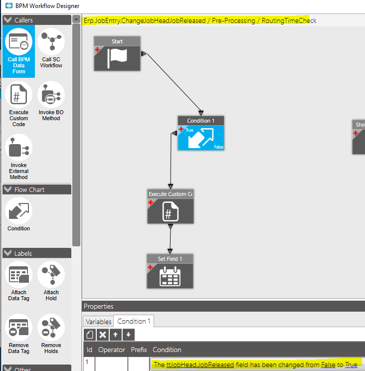

if i were you, i will create a pre-process method BPM on releasing Jobs, this way you will capture every job before hitting the shop floor, i have done many BPM’s on this BO method as well as EWB, the reason for that is that Epicor create jobs in a massive scale when running the MRP process in my environment, so i decided to capture these jobs at this point/transaction to allow only jobs with times, approved Supplier ID, sub.con. days out values to go to the shop floor, i can share any with you and you can alter to suit your use if you want
Thanks for your reply Al, we have not been Live for a year yet. I used to spend all my time writing the configurators. I am now trying to iron out some of the problems in production. We have quite a few! I’m ok but far from experienced with BPMs so any help / advice you can give would be much appreciated.

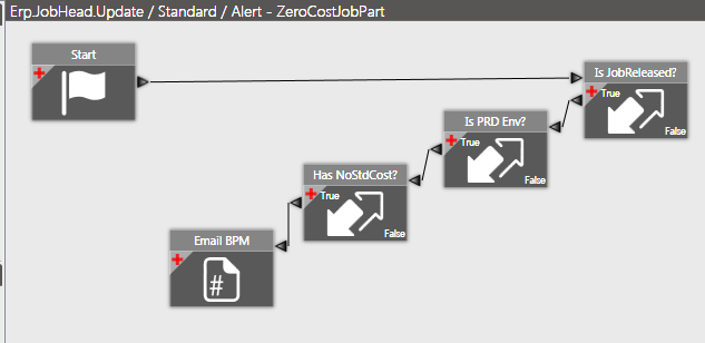

2019-02-13_0753
The HasNoStdCost? is a Custom Condition which returns true / false
/* Check JobAsmbl and JobMtl MINUS REFD */
var ttJobHead_Row = ttJobHead.FirstOrDefault();
/* JobAsmbls with No PartCost StdCost and Class not REFD */
bool hasJobAsmblsWithNoStdCost =
	(from ja in Db.JobAsmbl.With(LockHint.NoLock)
		/* Join on PartNum to get ClassID */
		join p in Db.Part.With(LockHint.NoLock)
				on new { ja.Company, ja.PartNum } equals new { p.Company, p.PartNum }
		join pl in Db.Plant.With(LockHint.NoLock)
				on new { ja.Company, PL = ja.Plant } equals new { pl.Company, PL = pl.Plant1 }
		join pc in Db.PartCost.With(LockHint.NoLock)
				on new { pl.Company, CID = pl.PlantCostID, PartNum = ja.PartNum } equals new { pc.Company, CID = pc.CostID, PartNum = pc.PartNum }
		where
			(( ja.Company == ttJobHead_Row.Company && ja.JobNum == ttJobHead_Row.JobNum )) &&
			(p.ClassID != "REFD") &&
			(pc.StdLaborCost + pc.StdBurdenCost + pc.StdMaterialCost + pc.StdSubContCost + pc.StdMtlBurCost) == 0
		select ja
		).Any();
/* JobMtls with No PartCost StdCost and Class not REFD */
bool hasJobMtlsWithNoStdCost =
	(from jm in Db.JobMtl.With(LockHint.NoLock)
				on new { jm.Company, jm.PartNum } equals new { p.Company, p.PartNum }
				on new { jm.Company, PL = jm.Plant } equals new { pl.Company, PL = pl.Plant1 }
				on new { pl.Company, CID = pl.PlantCostID, PartNum = jm.PartNum } equals new { pc.Company, CID = pc.CostID, PartNum = pc.PartNum }
		where
			(( jm.Company == ttJobHead_Row.Company && jm.JobNum == ttJobHead_Row.JobNum )) &&
		select jm
		).Any();
return hasJobAsmblsWithNoStdCost || hasJobMtlsWithNoStdCost;

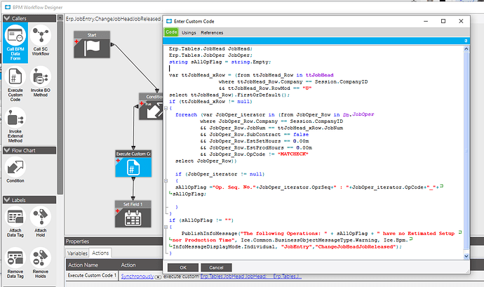

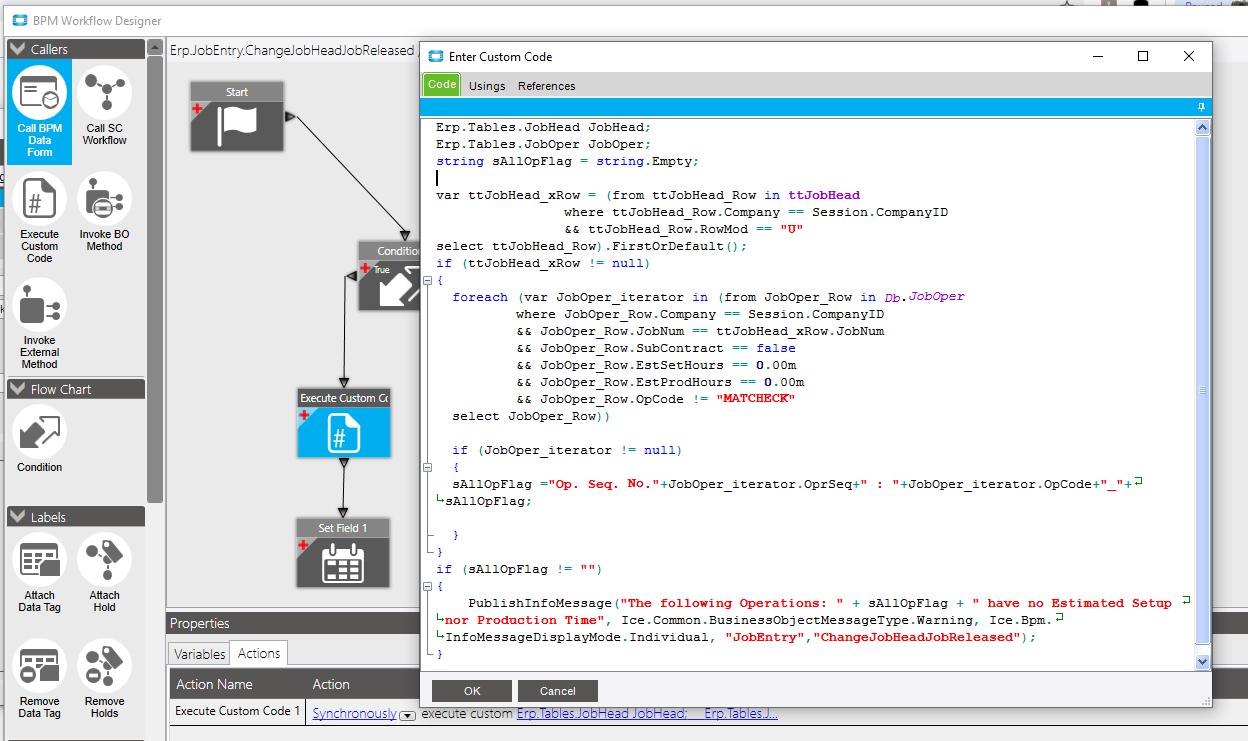

no problem mate, this is my BPM to check setup and production time for each operation on JobOper except our MATCHECK, the BPM will display a message to worn user then set JobReleased check box back to false, i have designed it this way to avoid cater for Firm, Engineered/ and UnEng transactions then run the update method, you can alter it to send you an Email instead if you want,
the code as text:
Erp.Tables.JobHead JobHead;
Erp.Tables.JobOper JobOper;
string sAllOpFlag = string.Empty;
var ttJobHead_xRow = (from ttJobHead_Row in ttJobHead
								where ttJobHead_Row.Company == Session.CompanyID
								&& ttJobHead_Row.RowMod == "U"
select ttJobHead_Row).FirstOrDefault();
if (ttJobHead_xRow != null)
	foreach (var JobOper_iterator in (from JobOper_Row in Db.JobOper
					where JobOper_Row.Company == Session.CompanyID
					&& JobOper_Row.JobNum == ttJobHead_xRow.JobNum
          && JobOper_Row.SubContract == false
					&& JobOper_Row.EstSetHours == 0.00m
					&& JobOper_Row.EstProdHours == 0.00m
					&& JobOper_Row.OpCode != "MATCHECK"
	select JobOper_Row))
	if (JobOper_iterator != null)
	sAllOpFlag ="Op. Seq. No."+JobOper_iterator.OprSeq+" : "+JobOper_iterator.OpCode+"_"+sAllOpFlag;
if (sAllOpFlag != "")
		PublishInfoMessage("The following Operations: " + sAllOpFlag + " have no Estimated Setup nor Production Time", Ice.Common.BusinessObjectMessageType.Warning, Ice.Bpm.InfoMessageDisplayMode.Individual, "JobEntry","ChangeJobHeadJobReleased");

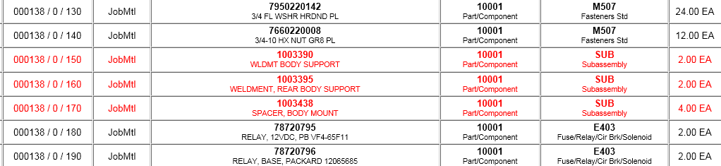

Mine sents a custom Email with the Entire Job with the ones that have issues in Red in a HTML Table which is Mobile Friendly to a point.
Now that is very cool indeed Haso
Given that I used a Template provided by the Community, I guess it should not be a problem to re-share it.
// Zero Cost Job Part Email
// 12/06/17 HK: Initial Implementation, since this is considered a temporary, lets keep it simple
// Initialize Actions
Func<string, string> GetCompanyAddressAction = (CompanyID) => {
	var Company_Row =

		EmailBody +=
		"<tr style='" + (TotalStdCost == 0 && JobPart_Row.ClassID != "REFD" ? "color: red;" : "") + "'>"
		+ @"<td align='center'>" + (JobProd_Row == null ? " - " : JobProd_Row.TargetJobNum + " / " + JobProd_Row.DemandPartNum) + "</td>"
		+ @"<td align='center'>" + JobPart_Row.JobNum + " / " + JobPart_Row.ParentSeq + " / " + JobPart_Row.Seq + "</td>"
		+ @"<td align='center'>" + JobPart_Row.RecordType + "</td>"
		+ @"<td align='center'><b>" + JobPart_Row.PartNum + @"</b><br><span style='font-size: 8pt'>" + JobPart_Row.Description + "</span></td>"
		+ @"<td align='center'><b>" + JobPart_Row.ProdCode + @"</b><br><span style='font-size: 8pt'>" + JobPart_Row.ProdGroupDesc + "</span></td>"
		+ @"<td align='center'><b>" + JobPart_Row.ClassID + @"</b><br><span style='font-size: 8pt'>" + JobPart_Row.ClassDescription + "</span></td>"
		+ @"<td align='center'>" + Math.Round(JobPart_Row.RequiredQty, 2) + " " + JobPart_Row.IUM + "</td>"
		+ @"<td align='center'>" + Math.Round(JobPart_Row.TotalStdCost, 2) + "</td>"
		+ "</tr>";
