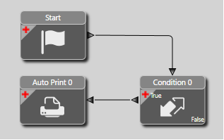

We have a Standard Data Directive BPM that fires on ShipHead when a pack is marked as Shipped. The BPM does an AutoPrint for EDI ASN’s (856). The BPM is quite simple, as shown here:

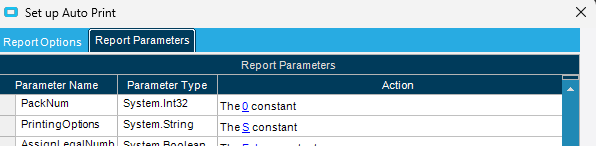

The AutoPrint is:

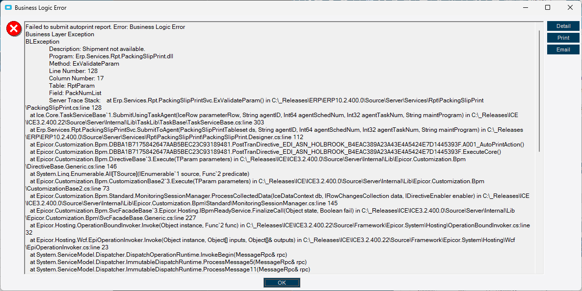

But, for some reason when we go and mark a Pack ID as shipped, we are getting the following error:
Description: Shipment Not Available ← Uhhh…what now? How is the shipment not available in a BPM that is triggered by a shipment?
Well, this would probably cause it…the PackNum being passed to the Report was ‘0’…
