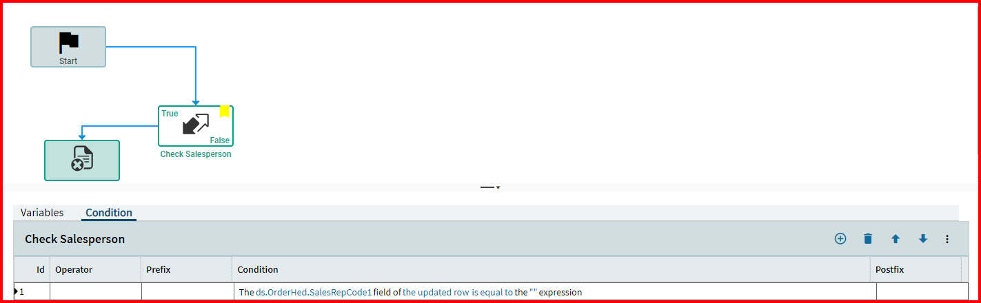

Upon updating the Order Header of a Sales Order it is trying to ensure a salesperson is added on saving
Can you post how the BPM is set up?

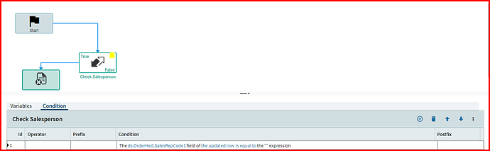

condition as below

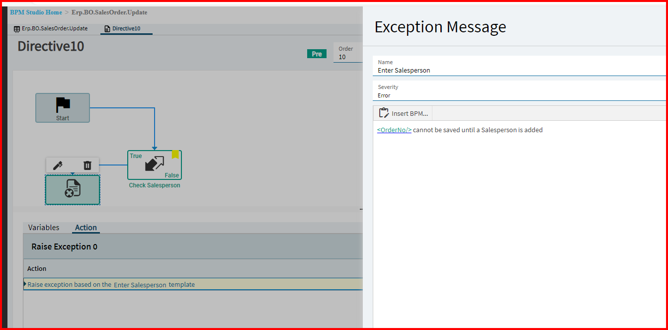

Exception
I’ve also used SalesRep in the condition
Try setting your condition where the SalesRepCode1 field is equal to the String.Empty expression.
May work better than using "".
