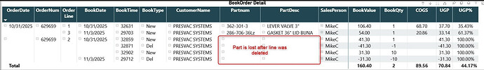

I’ve been tasked to create a solution for a situation that we have uncovered in the BookDtl Table.
We have an Orders Received report that references the BookOrder/BookDtl/BookRel Table because it manages changes over time of each line. Everything functions really well with it unless a line is deleted from the sales order. PartNum and LineDesc don’t exist in the BookDtl table, they get referenced from the OrderDtl Table.
When a line is deleted, we lose reference to both of those because they no longer exist in OrderDtl.

If we input a line for Part A, yesterday for $100, we captured that in yesterday’s total Orders Received Amount.
Today if that line for Part A is deleted, The bookdtl shows -$100, and a status of ‘del’. But we lose visibility into what that partNum was, because it is only referenced on the OrderDtl table.
The part numbers are tagged to additional pieces of information, right? Attributes / Classes / Groups. All of which I can’t reconcile once I lose that reference part number.
