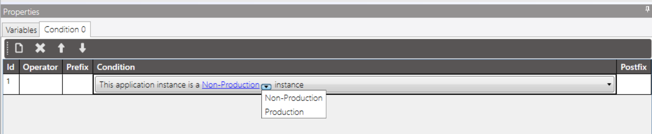

Starting in 10.2.500, there is also a Live flag that is set at the application server. Now Method and Data Directives have a new conditional available:

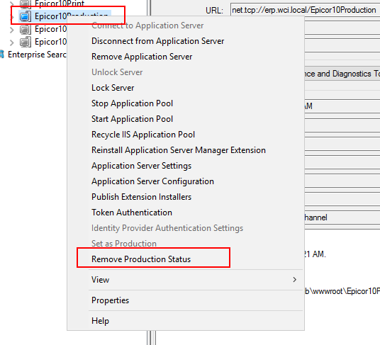

Remove your pilot production status
We’re cloud customers. I guess we should make a case then?
Sorry, I didn’t register that. I would definitely file a ticket for that. Their copy Live to Pilot should ALWAYS turn that off, don’t you think? DevOps does that for you… :wink:
