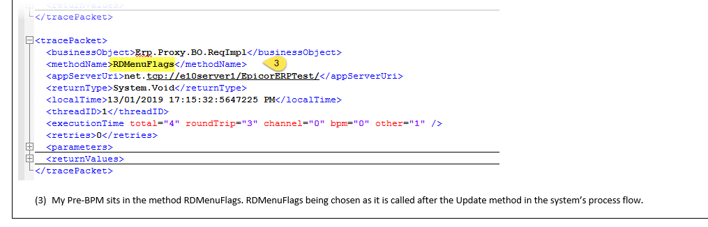

The first write is invoked normally in the (unmodified) Base Processing of the ‘Update’ method of the business object Req, initiated by user action on the Requisition Entry form.
The second write is invoked in my Pre-BPM on the method ‘RDMenuFlags’ of the business object Req. I have hooked into this method for no other reason than it always follows the Update method.
I Have attached some screen grabs that illustrate in more detail the process flow, as far a I can see the problem is with the 2nd write occurring within the same second as the 1st write. If only the PK field ChangeTime was in milliseconds.
