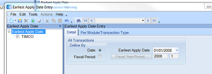

Are you talking Manual Labor Entries? If you move the GL Earliest Apply Date, any manual entries for any time prior to that would not be allowed because it would violate the EAD.

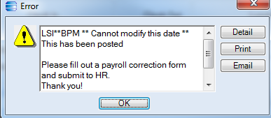

Come Monday morning a supervisor may realize he forgot to enter time for someone for vacation or whatever the case may be, so he goes in to T&E to enter that time. Epicor has a hard stop if you go into a date prior to posted date when you select “New time detail”.
I have put one in place if they select “New Time” first … because with this BPM in place it allows them to enter a new time and then a new time detail.

Earliest Apply Date – General Ledger – General Operations. Generally near the top of the menu.

Using the EAD, you are prevented in creating a transaction where the apply date in that category is prior to the date.
If you want to post prior to the EAD, you have to change the date and then after the entry you can change the date back.
Does the EAD only affect the Time and Expense module?
You have 2 tabs for the EAD. The Detail tab is used to control all transactions. The per module tab is used to control the transactions in the various modules.
As an example, you may want to cutoff all transactions for October 31 using the all transactions and cutoff your AR for November for November 30. Later you can cut off your Inventory or AP. Then when you have the month ties off, update the all transactions to Nov 30.
