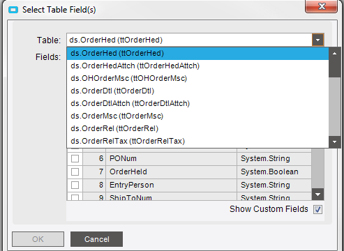

I am writing a BPM in the Order Release table. But at the same time I need it to change data in the Part Detail table. How to I go about doing that? Thanks!
The best way is to use a BPM that performs the SalesOrder.MasterUpdate method. This will update the PartDtl table properly and keep them in sync. Otherwise, C# code is the only other way I know.

In the SalesOrder.MasterUpdate method, it does not give me the option to set a field in PartDtl. Are there any documents that cover similar scenarios like this?
Are you invoking the BO method?
I am not. Should i be?
Yes. That is how PartDtl will get updated.
I am sorry. I am at a loss. I have no idea how to accomplish this using the invoking BO method.
The SalesOrder.Update Method (as well as MasterUpdate and UpdateExt) will update the PartDtl table properly.
I wish that OrderRel has triggers that updated PartDtl, but alas…
In 10.1.500+ (I believe), there is a widget that allows you to call a BO/Method.
