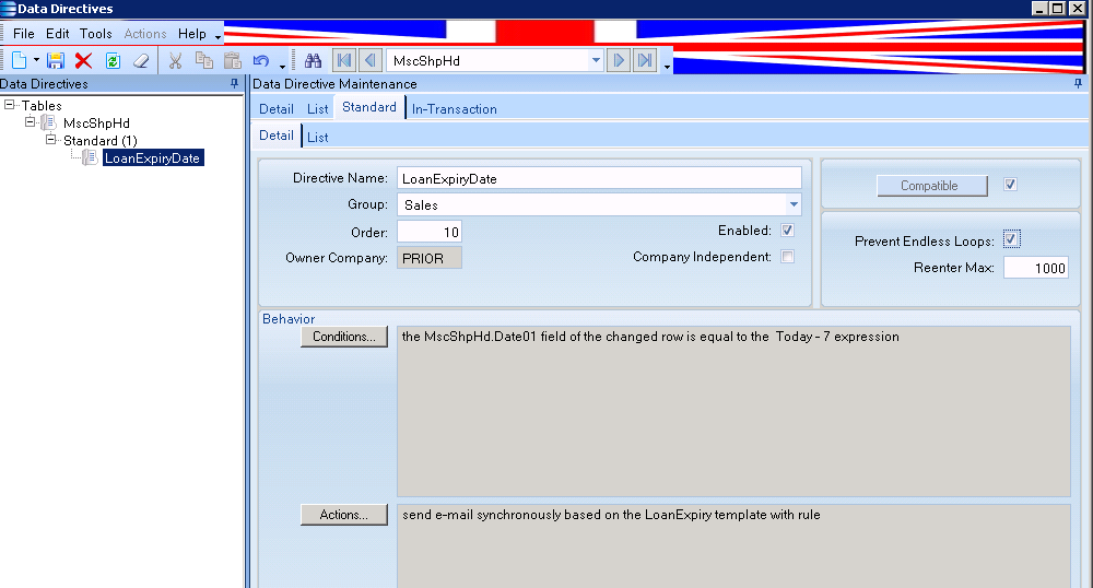

Standard Data Directive on the MscShpHed table using Date01 = Add-Interval( Today, -7, ‘days’).
It worked a treat!
getting better at these!

In the Actions part I ticked new and updated.

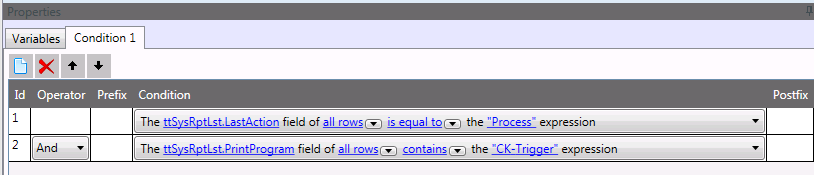

There must be process in that you don’t use that could be run on a schedule, and then have a BPM attached to that process. The BPM would execute Custom Code, which is where you’d pull in all the records of the MscShipHead (whose Date01 = TODAY() - 7 ). Then for each of those records, build your email and send it.
There are a few ways to do this within the confines of Epicor though most of them require custom code.
Other than those options you could do more invasive and not “supported” things like Database Triggers or schedule SSIS Packages
Out of all of those options I recommend you look into the Dot net IT scheduler (contact your CAM). It works within the Epicor framework and it is not a “HACK”
