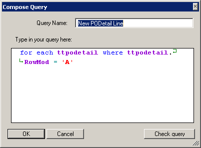

I have po.update (bpmethodcode) PO (business object)
ChangedRow should be fine.
PO.Update method Pre Processing
Conditions: “number of rows in the ‘New PODetail Line’ query is not less than 1”
[cid:image001.png@01D27DE9.CD53AA30]
Actions: “enable dependent post process directives”
PO.Update method Post Processing:
Conditions:
[cid:image002.png@01D27DE9.CD53AA30]
Actions: “synchronously execute 4GL for each ttporel. … record nothing”
[cid:image003.png@01D27DEA.10E9E930]
