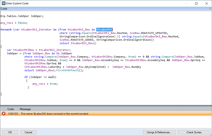

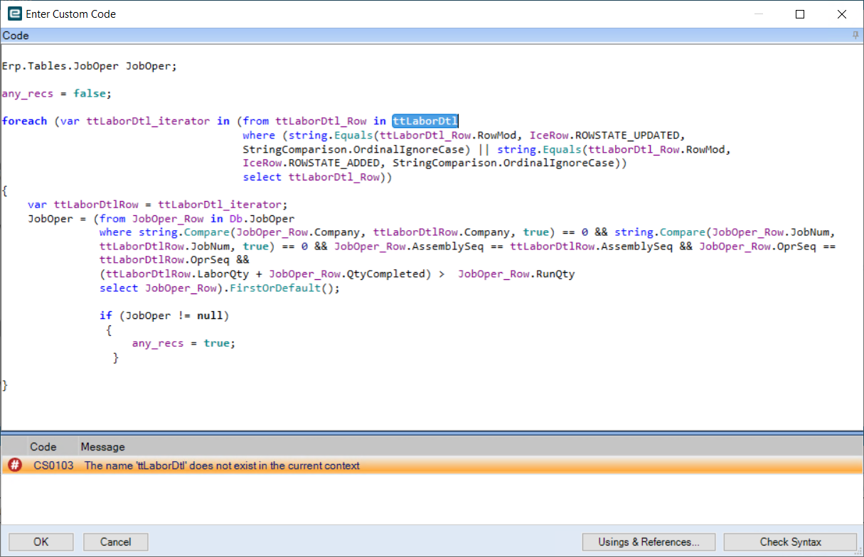

I picked this back up and added the variable but I am getting the following error on my custom code:
Ernie
(Ernie Lowell)
June 19, 2025, 3:02pm
24
Try changing “ttLaborDtl” to “ds.LaborDtl”
KBMihaila
(Karen B Mihaila)
June 19, 2025, 3:09pm
25
Ernie:
ds.LaborDtl
Ernie,
Do I do change it everywhere or just on that line.
Karen
Ernie
(Ernie Lowell)
June 19, 2025, 3:17pm
26
Everywhere. I’m not a programmer (and actual programmers are rolling over in the aisles when they see me answering questions like this), but I’ve had to make this change a lot.
gpayne
(Greg Payne)
June 19, 2025, 3:29pm
27
@KBMihaila You only need to change it on the top line.

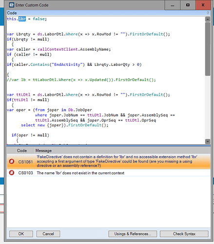

KBMihaila
(Karen B Mihaila)
June 19, 2025, 4:36pm
29

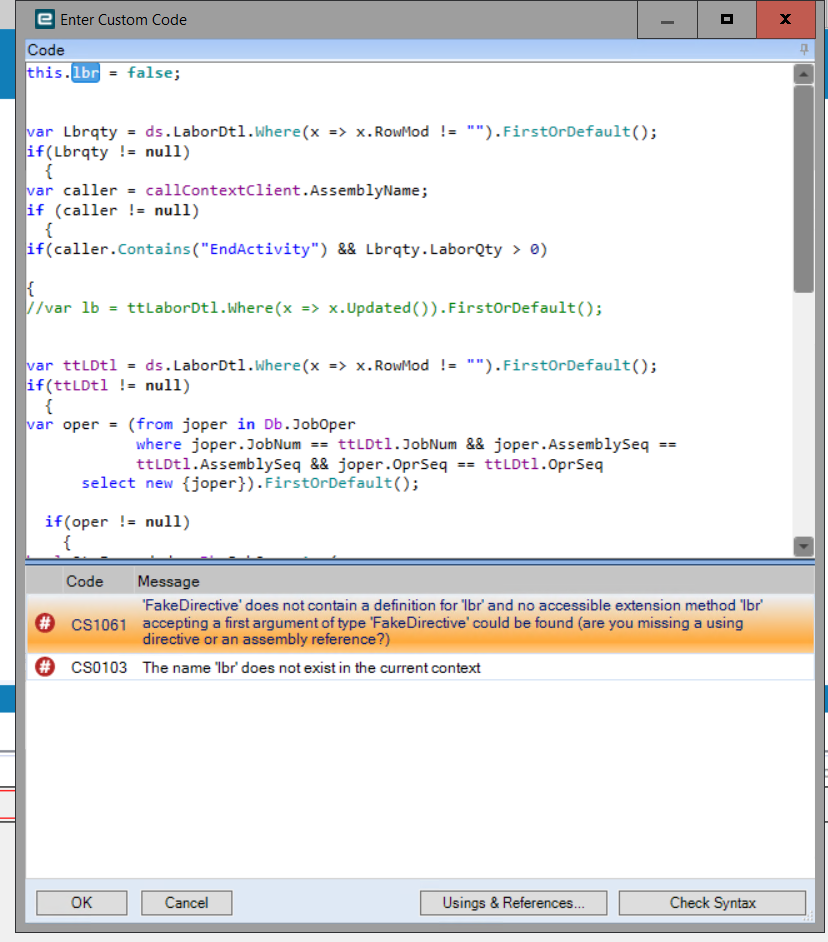

@gpayne
this is the errors I get when I use Craigs code:
Craig
(Craig Rogers)
June 19, 2025, 4:39pm
30
lbr is a global variable. you will need to create that first. its a Bool.

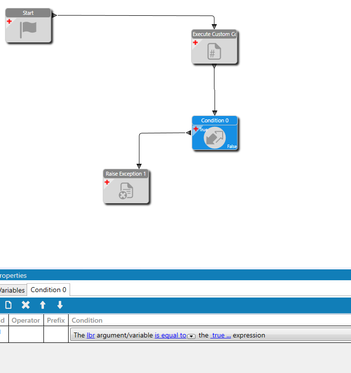

@Craig I am having no luck and am wondering if you can take a look at my BPM? See attached
Ticket 57212.bpm (21.3 KB)
KBMihaila
(Karen B Mihaila)
June 19, 2025, 6:38pm
33
@Craig
Disregard. I think I’ve got it! I will reach out with more questions.
