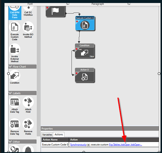

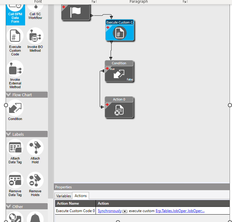

I am fairly new to BPM’s Can you expand what exacting the Custom Code is under the “Actions”
2023-11-29_11h48_56
Hi Karen,
If I understand your question correctly, the action 0 widget raises an exception that prevents the user from proceeding. It’s not custom code, it’s a text field where you specify what text is in the error box that the user will see if the conditions are met. If you download the .docx file above in this conversation, it goes through this step.
@KBMihaila are you asking what the custom code is on that widget? You just click ion the blue link thing and it will open up a window where you can see/edit it.

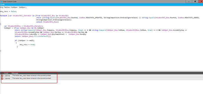

Hi Mike,
I understand now. But I am getting the following error message when I “Check the Syntax”

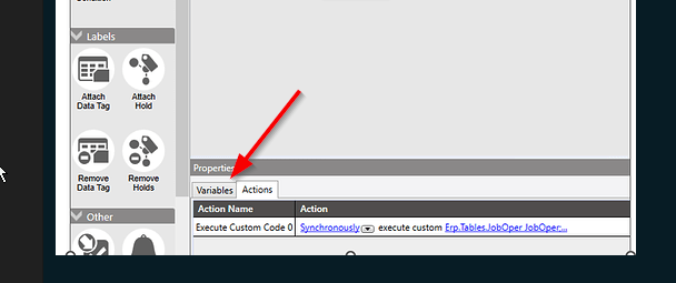

I’m just going off of screen shots, but I’m assuming that you need to create a variable in your BPM to set. So on the variables tab, create a new boolean variable call any_recs. Then I’m assuming that variable is used in the condition after the custom code block.
Oh I see!
In the main BPM Workflow Designer, add a variable, name it “any_recs”, and make it a Boolean type -

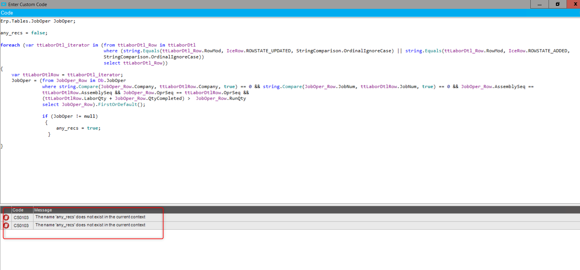

When I use the code specified in
https://www.epiusers.help/uploads/short-url/mUbV1v1eSnFLIauksNJ0PDdJjpO.docx
I get this error:
We are Kinetic Cloud. Do I need to reference dataset rather than tt tables? And if so, at what level? Here is the code I am experimenting with:
I apologize for formating of code, I struggled to make blockquote work.
Erp.Tables.JobOper JobOper;
any_recs = false;
foreach (var ttLaborDtl_iterator in (from ttLaborDtl_Row in ttLaborDtl
                                     where (string.Equals(ttLaborDtl_Row.RowMod, IceRow.ROWSTATE_UPDATED, StringComparison.OrdinalIgnoreCase) || string.Equals(ttLaborDtl_Row.RowMod, IceRow.ROWSTATE_ADDED, StringComparison.OrdinalIgnoreCase))
                                     select ttLaborDtl_Row))
    var ttLaborDtlRow = ttLaborDtl_iterator;
    JobOper = (from JobOper_Row in Db.JobOper
               where string.Compare(JobOper_Row.Company, ttLaborDtlRow.Company, true) == 0 && string.Compare(JobOper_Row.JobNum, ttLaborDtlRow.JobNum, true) == 0 && JobOper_Row.AssemblySeq == ttLaborDtlRow.AssemblySeq && JobOper_Row.OprSeq == ttLaborDtlRow.OprSeq &&
               (ttLaborDtlRow.LaborQty + JobOper_Row.QtyCompleted) >  JobOper_Row.RunQty
               select JobOper_Row).FirstOrDefault();
               if (JobOper != null)
                    any_recs = true;
