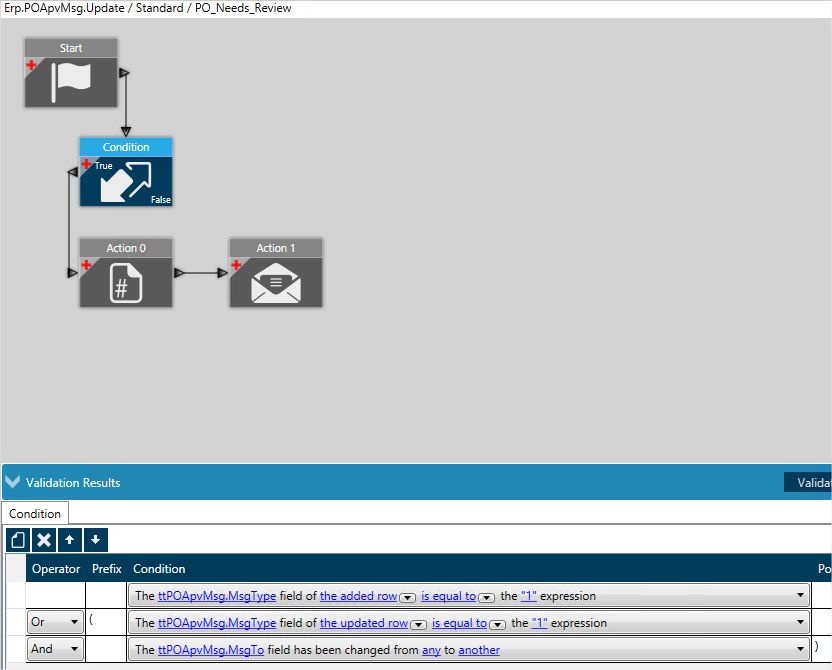

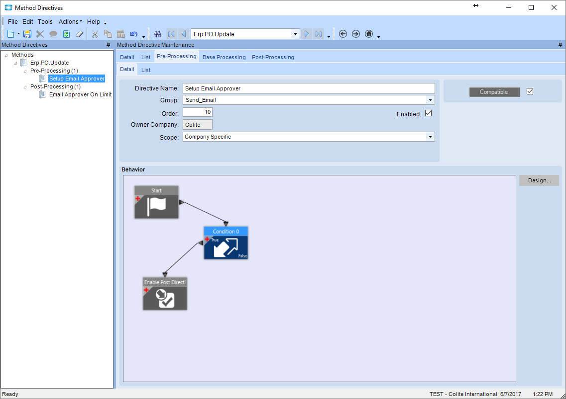

Just another take on how to do this, we only used C# code for looking up the Purchase Agent’s email addresses and assigning it to a BPM context for use later This is a standard Data Directive on the POApvMsg table:
