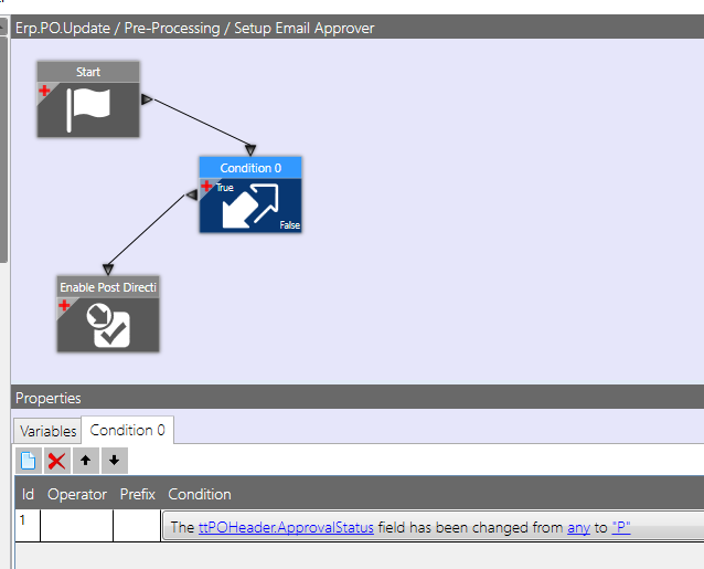

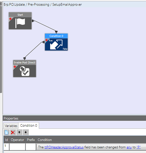

There’s a Pre-Processing setup like this:

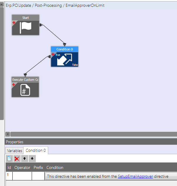

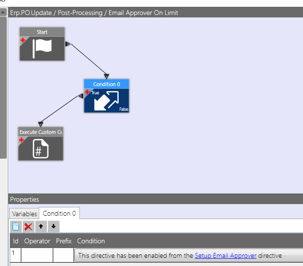

And a Post Processing setup like this:
The code in the Custom Code is:

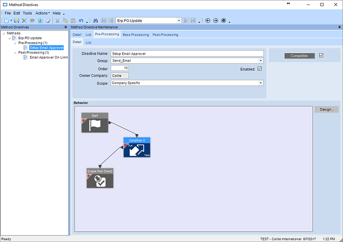

I set up a pre-processing and post-processing directive…
For the pre-processing directive, I set up a condition to check the approval status, then enable the post directive…
For the post-processing directive, I set a condition to look for the enable call…
