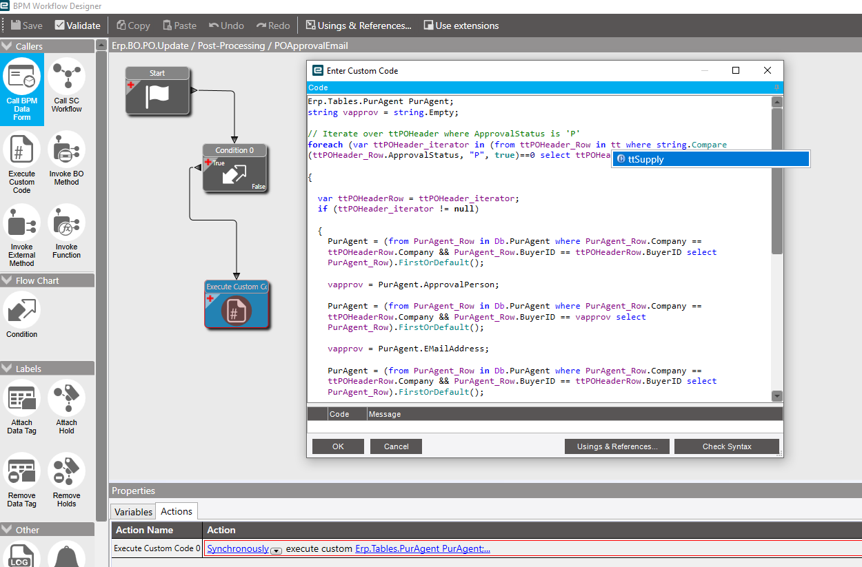

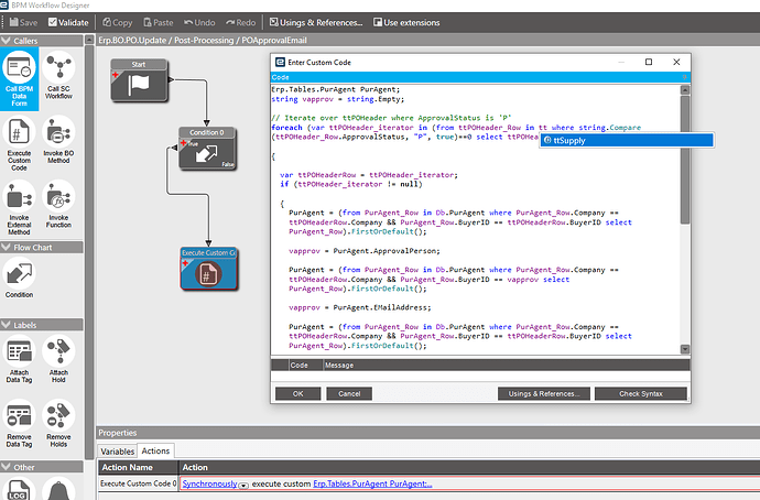

How ever, on the post processing custom C# code, I get the error “name ttPOheader does not exist in the current context” Is this because this solution was for an older version? and somehow now we cannot use ttPOHeader in post processing? (I’m on Kinetic 23.2)

thanks for the suggestion Nathan, I tried this and still no luck.
Tried this too, then I get that error same error for dsPOHeader … :cry:
I tried popping this code into a new Post-Processing BPM on PurchaseOrder.Update and the only error was down to a typo on Company in the PurAgent line. Once I corrected it, the code compiled fine.

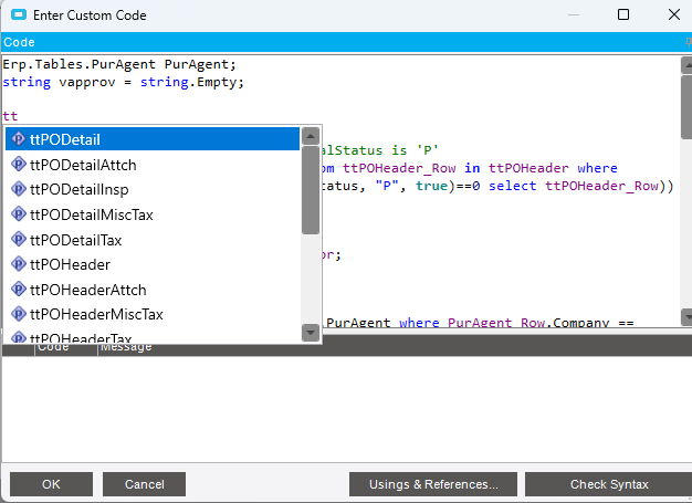

If you start typing ‘tt’ into your custom code editor then hit Control + space does intellisense show you anything? Here’s what I get:
If you’re not seeing this then you’re probably on a more recent version and will need to swap to the ds variables as @SueLowden suggested.

Good pickup on the Typo!! I corrected it. I Am on kinetic 23.2, I just tried your suggestion and this is what i get. I will try the next suggestion by Sue now. thanks Nathan!
That’ll be it. You’ll need to replace your lookup in the foreach loop to something like ds.POHeader, I don’t have a 23.2 instance in front of me to test, unfortunately.

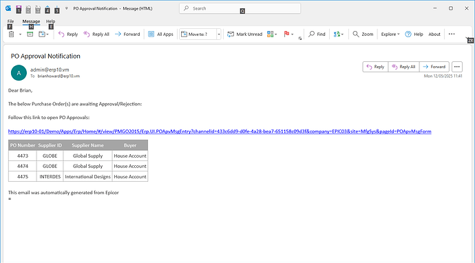

FYI - I have changed my approach to letting people know they have PO’s to approve, rather than “spamming” them each time a PO is submitted for approval, I have moved this into a Function that I can schedule.
The function gives them a list of PO’s awaiting their approval in a pretty SMTP table format and a hyperlink to the browser approval form so they can just action them.
Generally we schedule this function to run before the working day, mid-morning and mid-afternoon
The data comes from a BAQ and user codes
