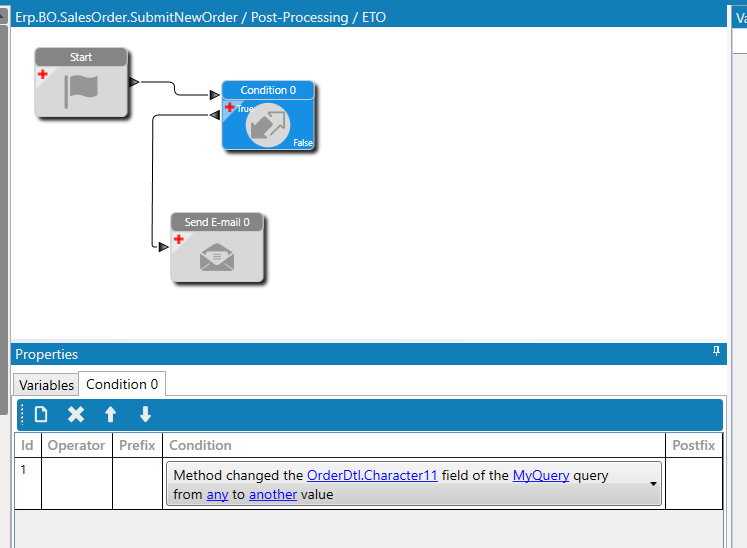

I am trying to create a BPM to send an email when a new sales order is created. I’m doing it on the Erp.BO.SalesOrder.SubmitNewOrder. I am not getting an error the email is not sending. I’ve tried but pre and post processing. Any suggestions would be appreciated.

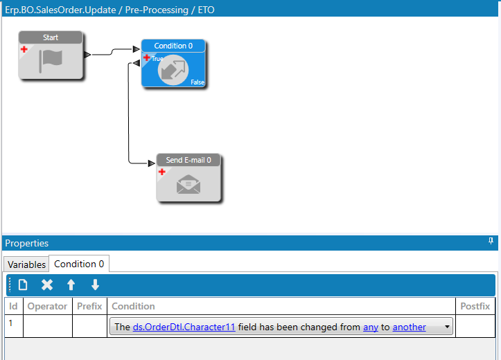

It successfully sends emails when I do a BPM on Erp.BO.SalesOrder.Update.
When I do this BPM it does nothing no error and does not send an email.

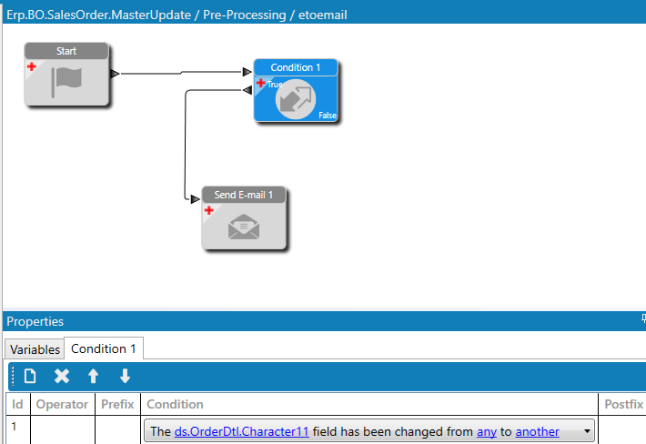

I did just a send email on the Master Update and that sent right away. Now I want to add a condition where if a UD checkbox or UD text field is populated the email fires.
I’m doing the condition here and it does not fire the email.

If something is there. I set the Erp.BO.SalesOrder.Update to send an email if it changes.
