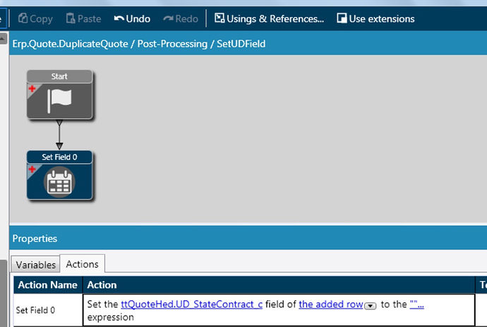

Tried this and it doesn’t seem to be working, at least in my test environment.
Possibly try changing Added to Changed. Otherwise, I’m almost positive it could be done in a Data Directive, with Added. Epicor has always been a bit of hit and miss as to the timing of when the data gets written, sometimes it’s partially written before you actually Save it.
I usually try Method first, then if I can’t fix it with that, go to Data. Or even a combination. The other option would involved C# code in the customization and it doesn’t seem like you wanted to go that route. (though I have done that many times as well)
The Data Directive with Added worked exactly the way I needed. Thanks!
