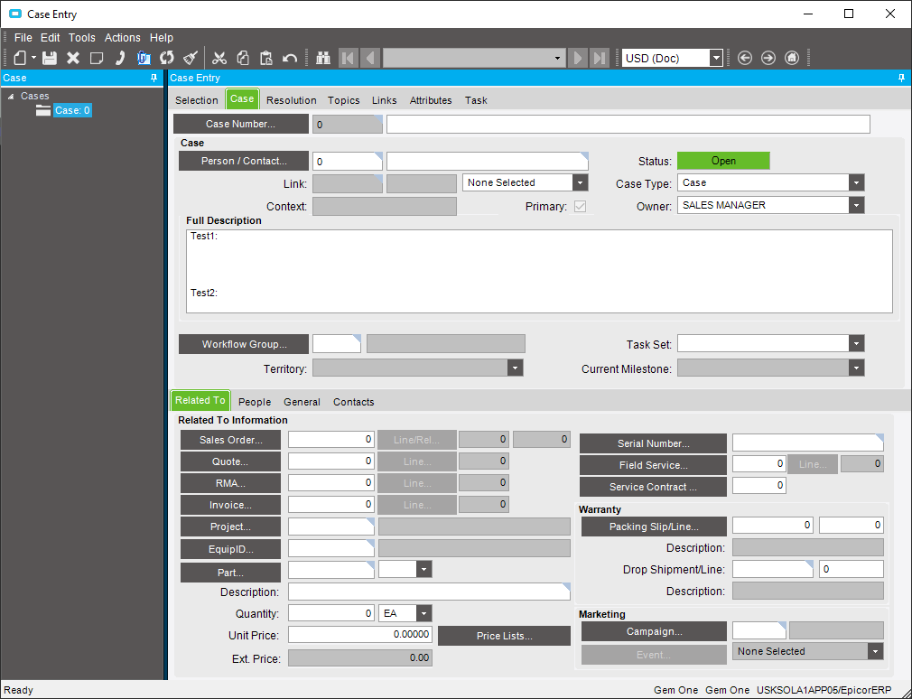

BPM to Set Value of HDCase.IssueText on creation of Case

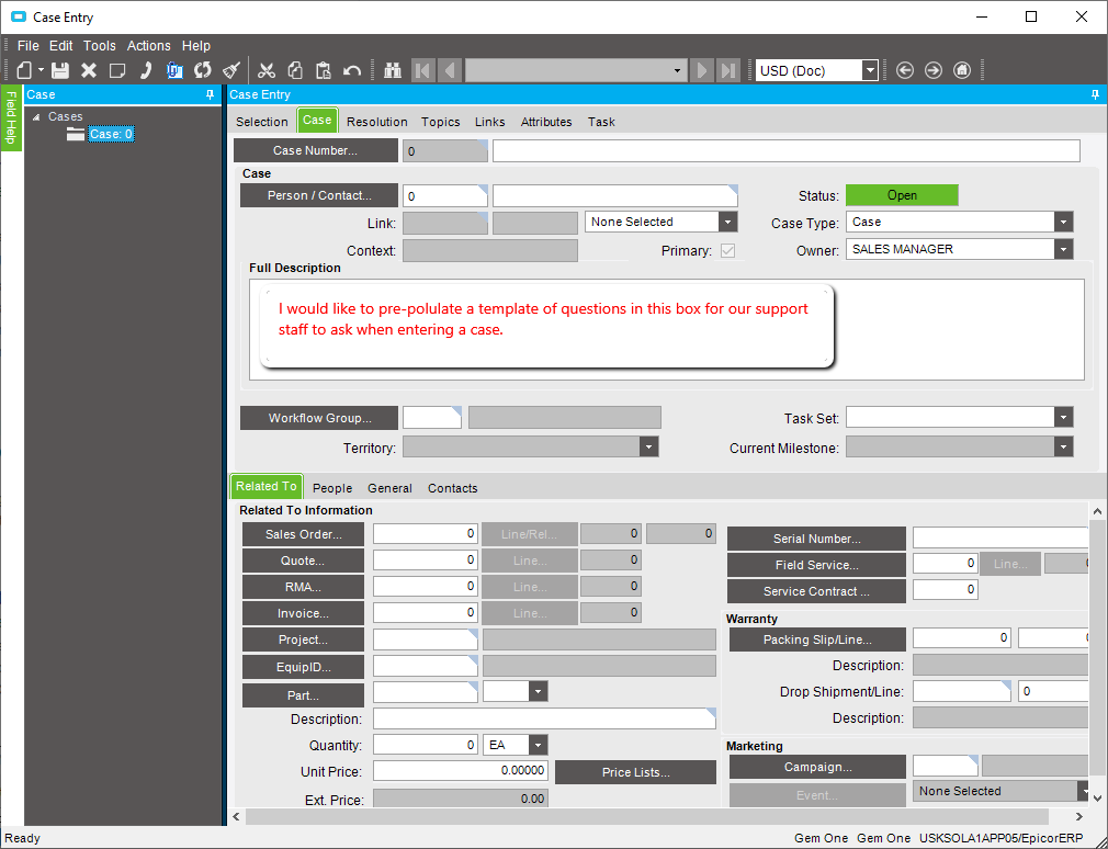

When a user opens case entry and creates a new case record I would like to set the value of the Full text textbox with a list of questions for users to ask when on a call.

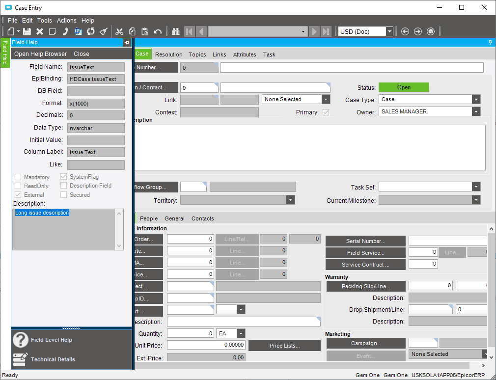

I have run tracing. Found the method directive. created a new pre-processing method directive:
I inserted a show message statement so I know the method directive is getting called.
But I can’t figure out how to get the method directive to set a value in that textbox.
