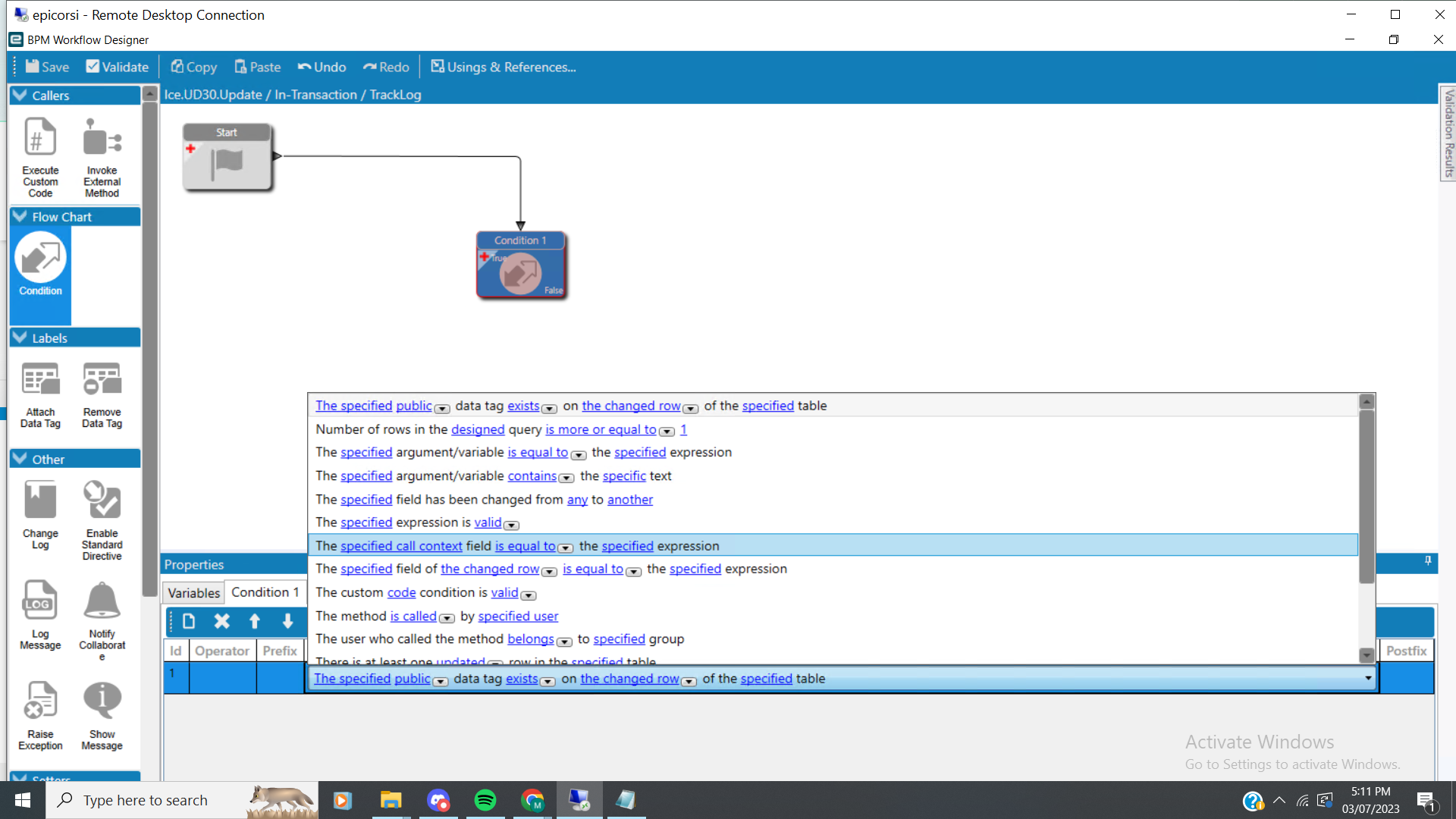

Referring to the steps above, I created a UD30 Table and the create a new in-transaction data directive for UD30 table. My question is, how do I set the condition to detect if the other table such as InvHead has a data deleted?
Or in this case I go to the InvHed table and set the condition there?
Yes. You will be setting all your in-trans data directives on the tables that are having the changes.

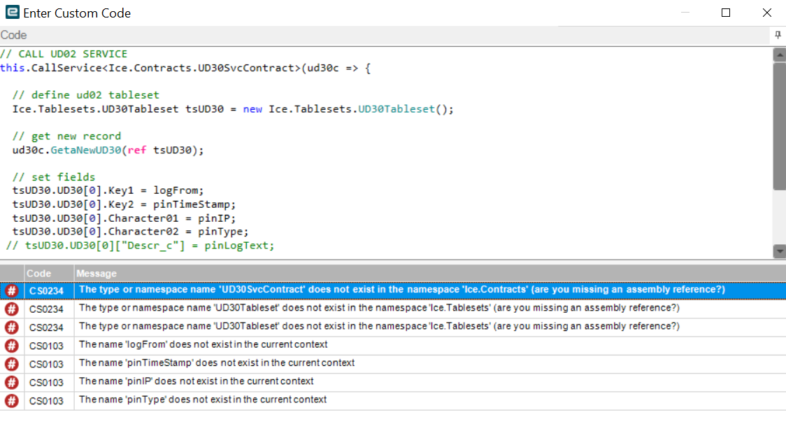

So I did the condition as long as InvcHead table data deleted it will run the code. But I get the error below.
Please bear with me as I am a beginner at coding. Thanks everyone
Click Usings and References → References → Add
Find Ice.Contracts.BO.UD30 → Click OK
@Dragos Example was incomplete, he was just showing an example.
My example is also incomplete, but explains a bit more:

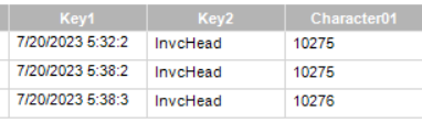

Thanks for the replied, so I tried teh code made some changes then fixed the error but after that when I tested in Ar Invoice entry I got this. Likely due to the fact the table has these fields but no data is being inserted.
For the log value field currently its just the invoicehead.Invoice Num, will try to change it to a string of values later on…but that’s in a later step on my guess.

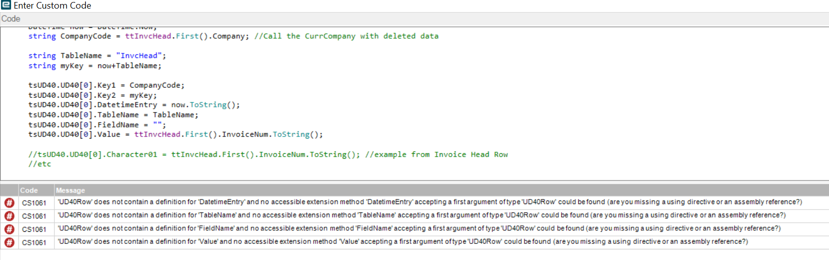

So I changed the coding as per above but I think I’m misunderstanding the way the coding works? I thought the line tsUD40.UD40[0].Key1 will insert the data into Key 1 in my table but when I do the same for the other 4 fields I get the error as below.
Is there another reference I need to add?
The coding, no, but the fields yes.
UD40 does not contain any fields like DatetimeEntry, TableName, FieldName, Value etc.
You will have to either chose from the existing fields, like CharacterXX, ShortCharXX, NumberXX, etc
or you can add fields to the table (I won’t cover that here)
You can look in the Data Dictionary, or make a BAQ and see what fields are available.
Also when you’re coding, the fields will show up in the autocomplete when you press
Ctrl + Space after the dot on tsUD40.UD40[0].

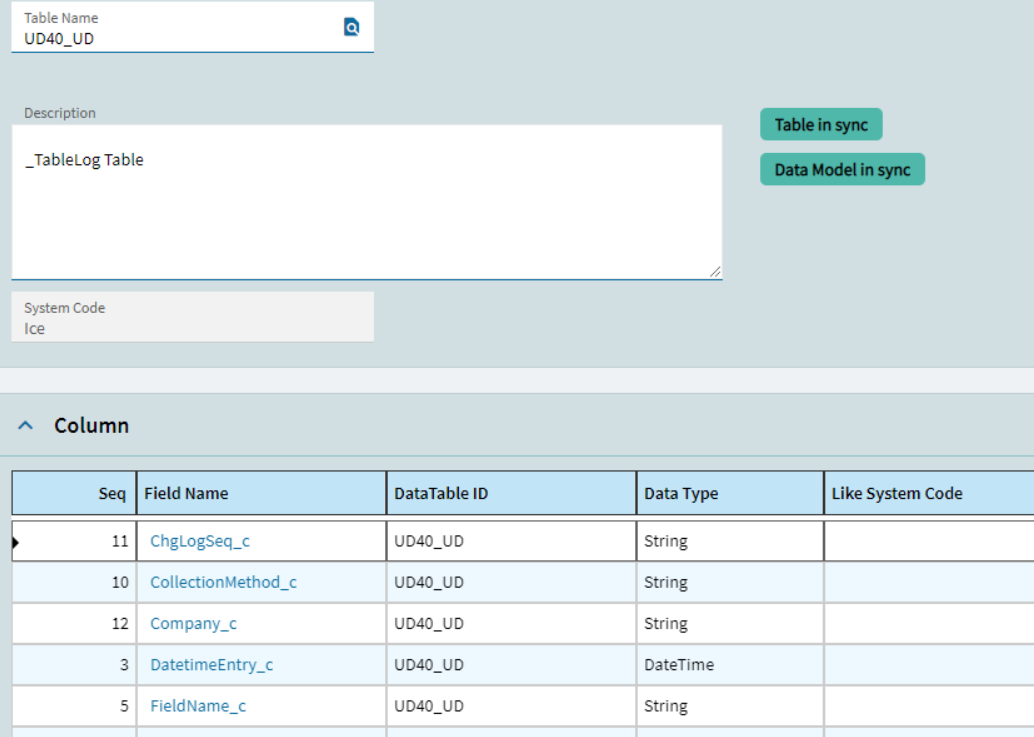

I did add fields before I started coding. Will try the Ctrl Space. Thanks :smiley:
I’m an idiot. After thinking through for a bit I thought ‘why create new fields and not just used the existing ones? Duh’ :melting_face:
