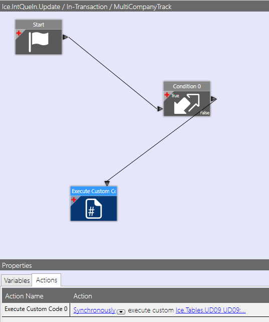

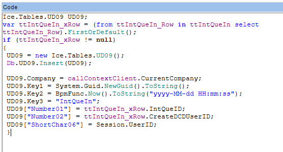

I would like a BPM to track deletions to table IntQueIn which tracks interface transactions. I saw a similar request for deletions on table InvcHead and tried to use the same sort of logic however it’s not working correctly. I’d appreciate any insight into what’s wrong with this BPM (I’m new to this). When I enable it the transactions don’t come through via the integrated table workbench.

From the quick looks of it, I would recommend you wrap the whole UD09 inside a TransactionScope and lastly you need Db.Validate(UD09); or just Db.Validate(); to actually commit the Insert to the database.
Epicor Wraps Entity Frameworks SaveChanges() into Db.Validate();

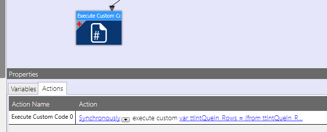

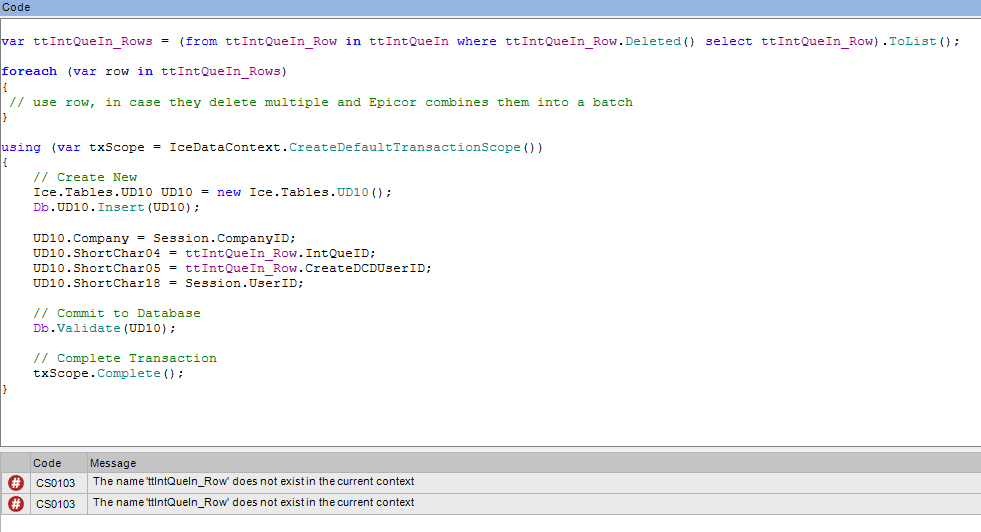

Thank you so much for your response and I’ve tried to put in some new code based on your suggestion but I get the errors shown below. I’m no programmer so would appreciate any input to correct this.

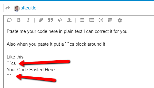

Paste me your code here in plain-text I can correct it for you.
Also when you paste it put a ```cs block around it
Like this:
2019-04-17_0913
OK here you go - thanks
var ttIntQueIn_Rows = (from ttIntQueIn_Row in ttIntQueIn where ttIntQueIn_Row.Deleted() select ttIntQueIn_Row).ToList();

Perfect, try this:

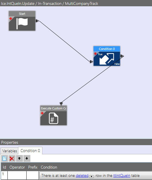

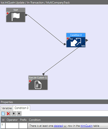

this is your issue mate,
you need to connect your arrows this way:
It worked!! Al & Haso I am incredibly grateful for your guidance. I owe you both a drink.
