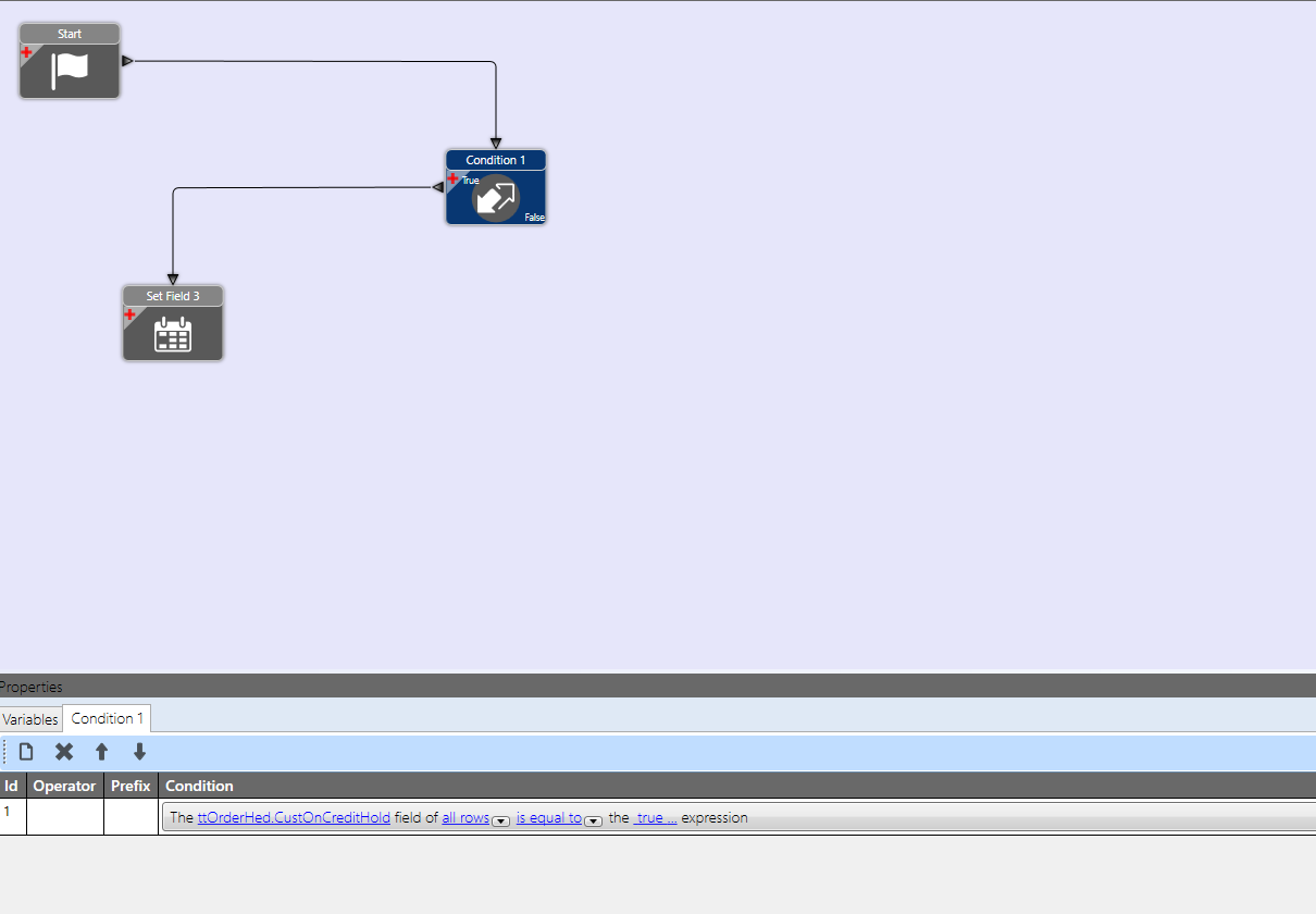

I’ve created a simple BPM to unfirm all the sales order releases when the customer goes on credit hold.
Once the customer is on hold, I’ve set the firm release field to false on all rows. When I click on the order release tab, I can see that the firm release checkbox changes to false. So that part seems to work.
The issue I’m having is that when I close the sales order and go back into it, I see the firm release is checked again, even if I click save before closing the sale order.
Is there something I can do to make this work?
thanks.

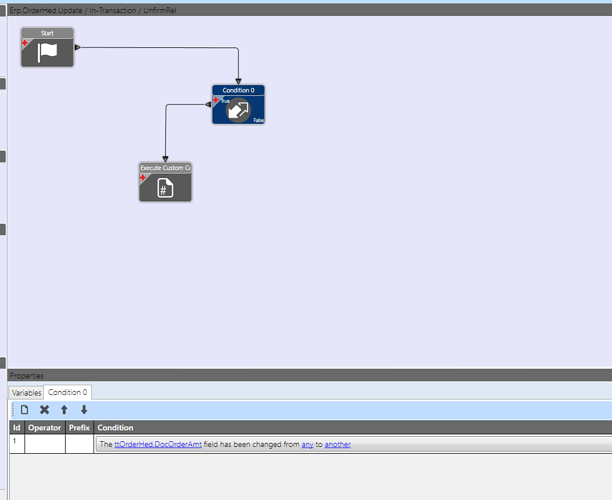

I managed to get this to work. I created an In-Transaction data directive on the OrderHed table, with the following conditions.
This is the custom code I used:
var tt = ttOrderHed.FirstOrDefault(r=>r.Added() || r.Updated());
// Get the CustomerID
var contactRow = (from contact_Row in Db.Customer where contact_Row.CustNum == tt.ShipToCustNum select contact_Row).FirstOrDefault();
bool CreditHold = contactRow.CreditHold;
bool CreditOverride = tt.CreditOverride;
if( tt != null )
    if (CreditOverride == false)
      if (CreditHold == true)
         foreach (var openRel in Db.OrderRel.Where (x =>   x.Company == tt.Company &&
                  x.OrderNum == tt.OrderNum))
               if ((openRel.OpenRelease == true) && (openRel.FirmRelease == true))
                    openRel.FirmRelease = false;
         Db.Validate();
