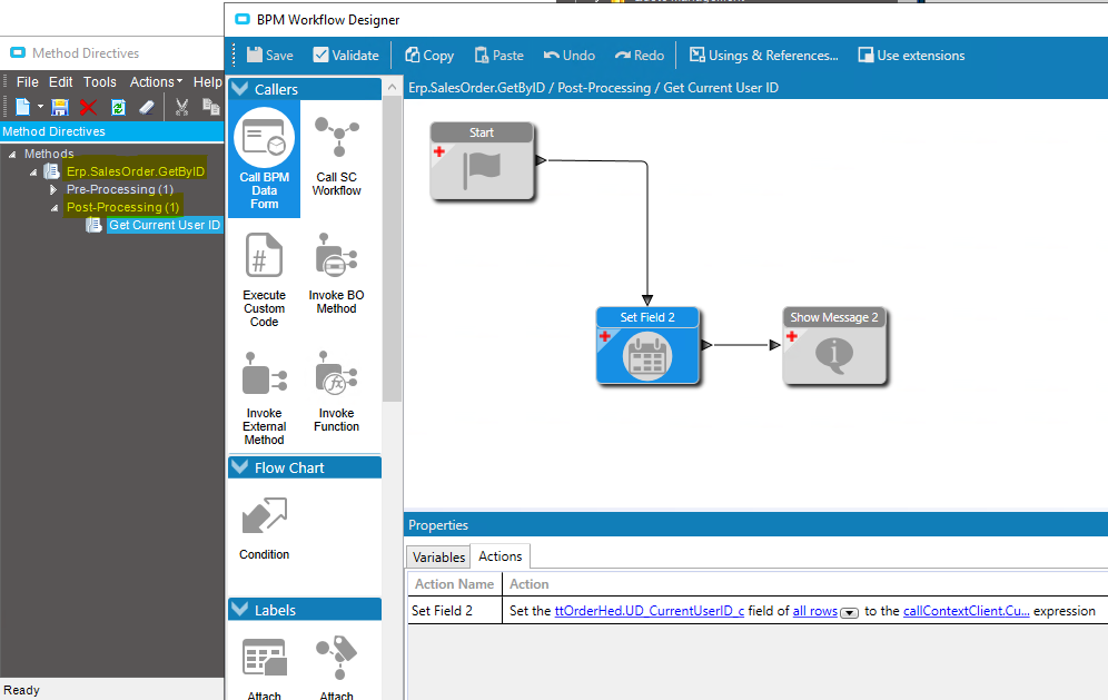

This time I am trying to go the BPM route. It is working OK to a point.
The Post-Processing Method Directive on SalesOrder.GetByID sets call.ContextClient.CurrentUserID in my OrderHed UD field so it’s visible when a Sales Order is opened on a screen. Unfortunately, I can’t save it to the OrderHed Table (I don’t know how).

The SalesOrder.GetByID Post-Processing Method Directive is the only one that would display the Current User ID on the screen when the order is opened. Unfortunately, it wouldn’t save it to my UD Field for later use in Breaking/Routing of a Report Style.
I’ve tried SalesOrder.Update pre and post Method Directive, SalesOrder.GetByID pre, Data Directive In-Transaction and Standard on OrderHed and none of them would display the Current User ID in my TextBox bound to the UDField.

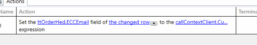

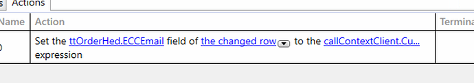

You don’t want to display the user. you just want to save it. Post processing on getbyid is going from the server to the client so nothing is saved. Preprocessing on update is going from the client to the server, so any field you set there will get saved to the database. I did not have your UD, but the update did work.
I just did this in 10.2.400 order update
set field

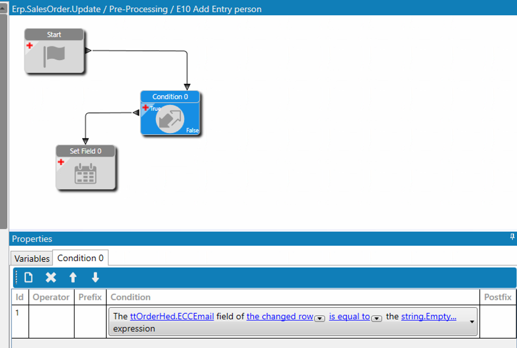

I set it exactly to your example with omitting the condition, because I would like my UD field to be set to a current user each time someone opens an order.
It does NOT save anything to the server (I’ve tried setting it to the changed row and all rows). I know it because I created a simple BAQ with OrderNum and my UD field column. It reminds empty unless I save some change on an order.
